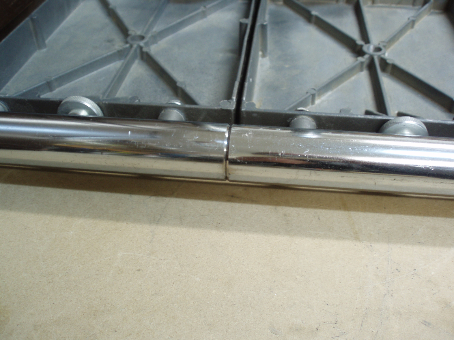

First the original rail. The connecting tube is inserted and the ends are flush.
510 rail orig.jpg (258.69 KiB) Viewed 7120 times

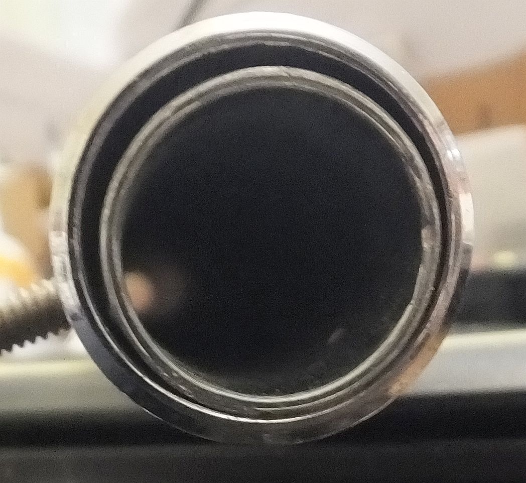

Notice the od of the connecting tube is nearly the same as the id of the rail. Look closely at the top gap - the end of the rail has a slight bevel so look for the 'dark void'. They differ by about 0.012". A reasonably tight fit. Not much 'wiggle' room up/down as the jack screws are tightened from one 'side'.

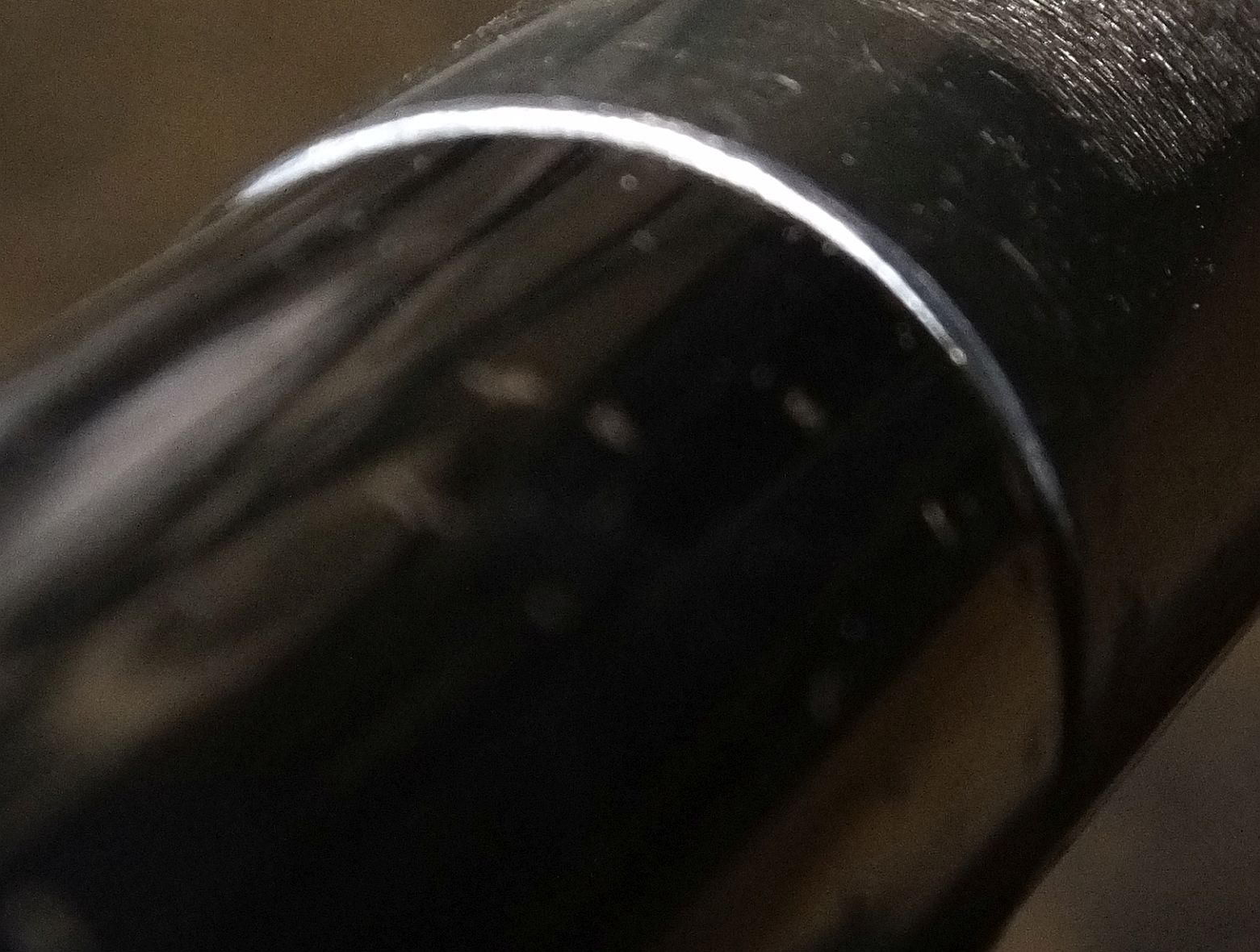

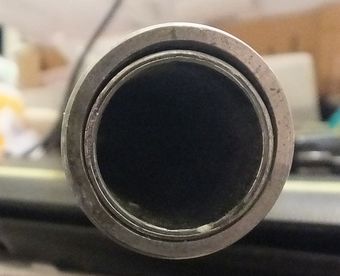

Now the current rail. Again the connecting tube is inserted and the ends are flush.
510 rail current.jpg (234.7 KiB) Viewed 7120 times
Now there is a considerable gap between the connecting tube and the rail. They differ by about 0.035"(the id of the rail is 0.023" greater than the original rail). The connecting tube will tend to shift either up or down as the jack screw is tightened from the side.

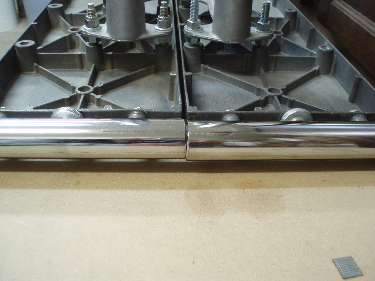

Finally a peek at the two rails butting against each other on a connecting tube. The 'left' rail is the current size. The 'right' rail is an original size.
510 rail both.jpg (284.73 KiB) Viewed 7120 times
This illustrates the difference since the opposite sides of the rails both are tight to the far side of the connecting tube. However a typical setup would have one rail supporting the connecting tube(tube setting on the 'bottom' of the rail) and the other rail setting on the 'top' of the connecting tube. That would result in less difference between the table tops.
Critical? Depends upon the setup and how persnickity the operator is. However an aggravation and potential cause of a goof if the two version are mixed in a setup.
Now there is a considerable gap between the connecting tube and the rail. They differ by about 0.035"(the id of the tube is 0.023" less than the original rail). The connecting tube will tend to shift either up or down as the jack screw is tightened from the side.
Finally I believe a mix is actually more predictable than with an all
current' setup. The supporting end of the connecting tube setting on the bottom of one rail and the other rail setting on the top of the connecting tube could vary in 'height' by close to 3X the amount shown in the last pix.
JPG thanks for showing those pictures! They clearly tell the story as to why I hated the 510 setup. The difference in between the fence rail and the connector tube gave my Aux tables nearly a 1/4 in movement in reference to my main table. If I remembered to lift up or push down as I was tightening I could get the table on the same plane. But the minute is forgot the tables would get out of plane. This stopped the fence from smoothly sliding over to the Aux table. Made some cuts of wood have slight bevels and frustrated me to the point I stopped working on the Shopsmith altogether. In fact if the 520 hadn't. Come out I would have sold my Shopsmith by now or converted it back to the 500. I hated the 510 and I believe Shopsmith should stop production of it. Piece of junk in my opinion.
