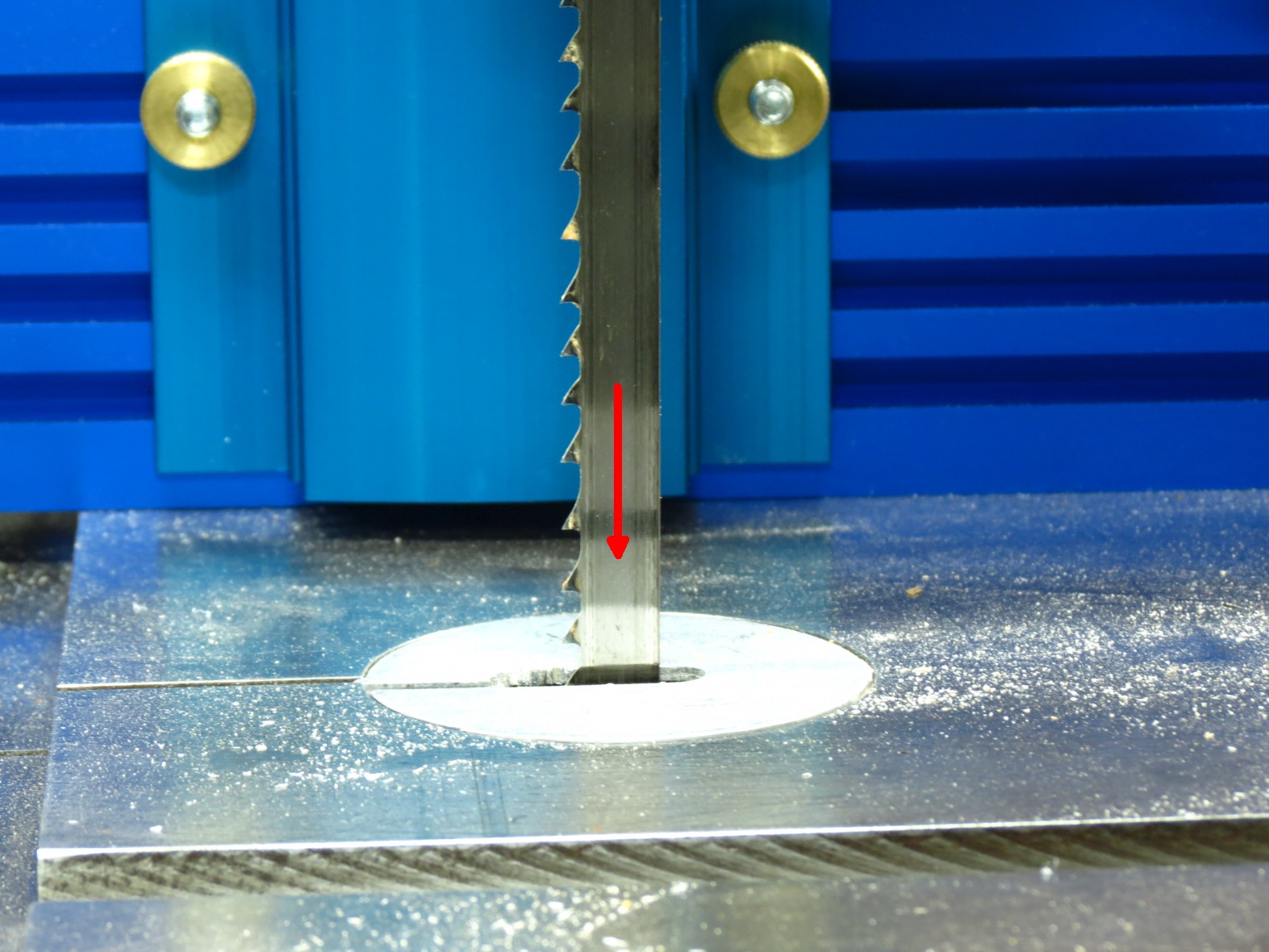

Before you do any strong arm changes be sure to do as Charles said and look at the blade. The teeth must look like this:
blade direction as shown with the red arrow.

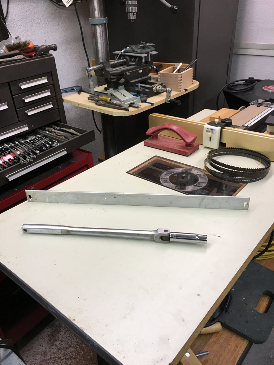

I have the blade installed correctly. I removed the upper wheel and used a break-over and a 1/2" deep well socket to get the required 1/4" gap. It took a pretty good effort to achieve this. I would like to meet the gentleman that can do the same pulling on the bottom and pushing on the top to get the 1/4" gap. I re-installed the Timberwolf and now it is tracking perfectly.

- IMG_0479[1].jpg (710.34 KiB) Viewed 5947 times
