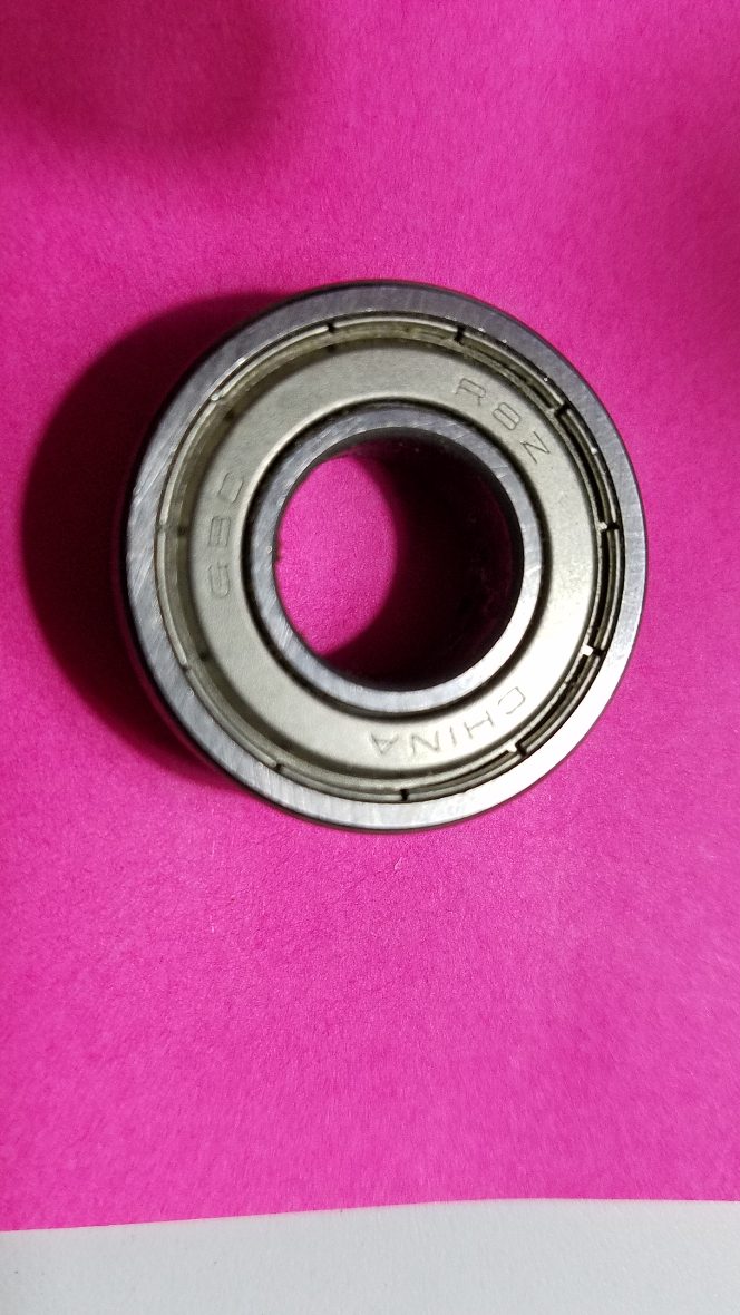

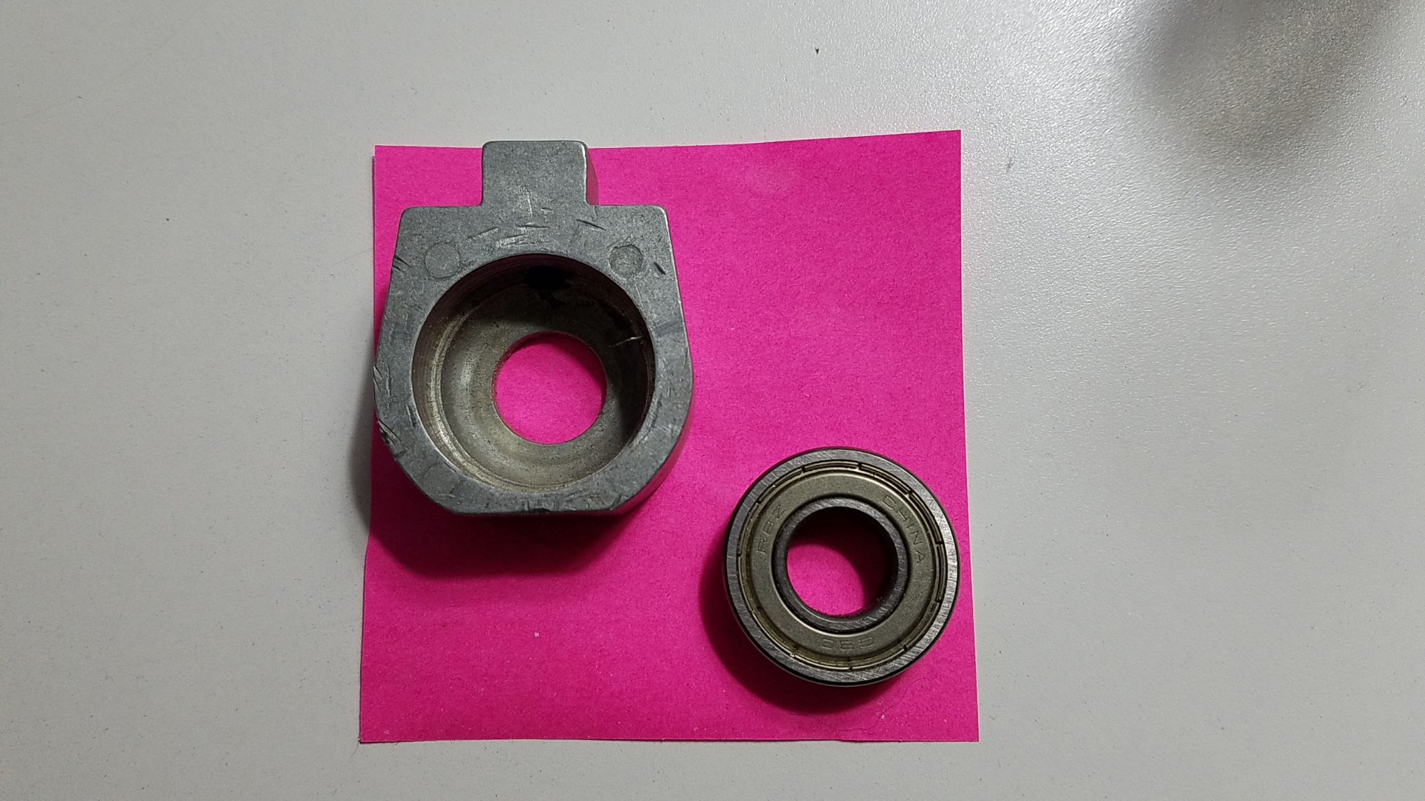

Anyone know the correct size for the jointer bearings? Bearing numbers??
Bill V
Re: bearing sizes
wa2crk wrote:Anyone know the correct size for the jointer bearings? Bearing numbers??
Bill V
I believe you are looking for R8-2Z and it measures 12.7mmx28.575mmx7.938mm and is shielded both sides.
Jointer Cutterhead Bearing 001.jpg (1.75 MiB) Viewed 7821 times
Jointer Cutterhead Bearing 002.jpg (775.13 KiB) Viewed 7821 times
The bearing shown is from China, don't know manufacturer but it is marked R8Z.
http://www.vxb.com/R8-2Z-Dia-12-7mm-OD- ... AqlL8P8HAQ
PS It is also marked with the manufacturers code GBC.
http://www.generalbearing.com/products.html
http://catalog.generalbearing.com/db/se ... nch_series

Re: bearing sizes
1 1/8 x 1/2 x 5/16
Re: bearing sizes
[quote="JPG"]1 1/8 x 1/2 x 5/16[/quote
I don't know what the difference is.
http://www.vxb.com/R8ZZ-Shielded-Bearin ... As1F8P8HAQ
vs
If they are form, fit, function equivalents, I would not expect VXB to list both numbers. The later is what is in my jointer. The image is of one that I replaced.
