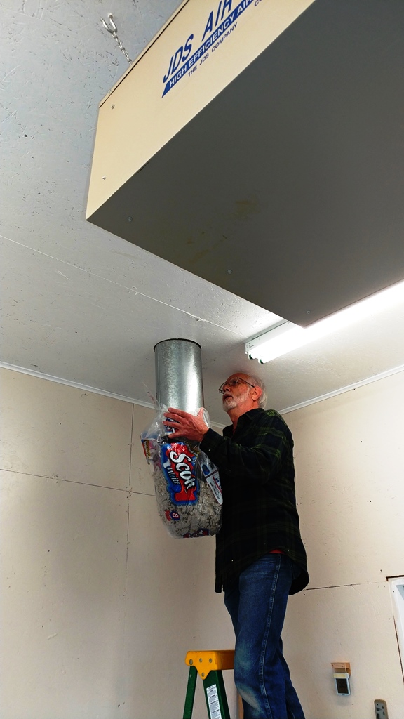

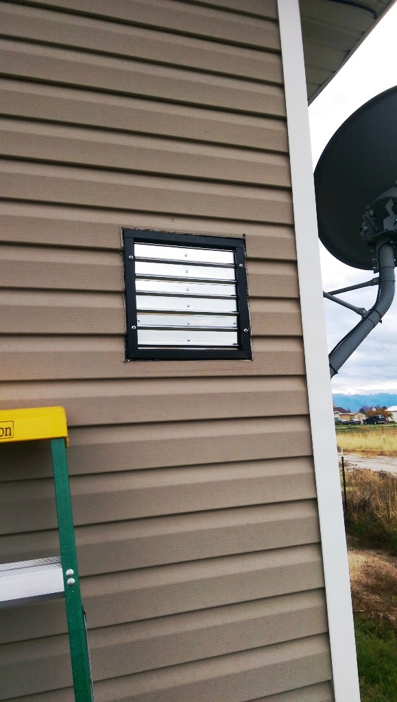

I have a 10' X 12' finishing room in my shop. It has a JDS 1200CFM air filter hanging from the ceiling. Over the years it has been adequate because I don't do a lot of spraying. When I refurbished my first 10ER last year the spray primer made a mess. It dried before is settled on things so was easy to clean up but...

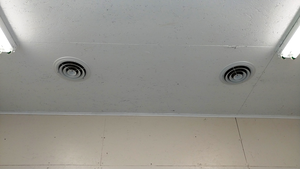

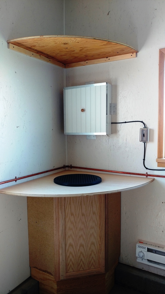

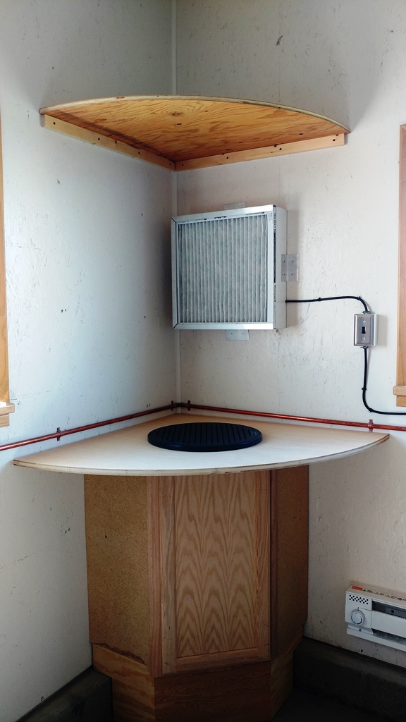

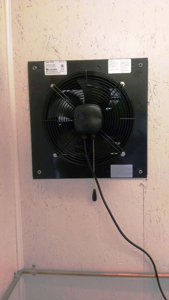

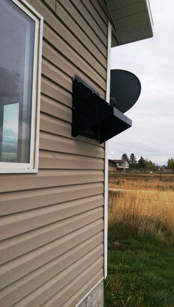

An exhaust fan seemed appropriate and an area to spray small items like the 10ER parts. Here is the result but it is still in work. The cabinet is actually an upper corner kitchen cabinet. They were on sale a Home Depot, it was damaged so I got an additional discount and I got my Military discount. About $40. The fan is 1200 CFM. The shop is so tight I needed make up air. In stead of just opening a window I put vents in the ceiling to get air from the attic. The thought was that in the winter if it is cold and sunny the attic air will be warmer than the outside air.
So here are the pictures of the progress so far.

Whodat on de ladder?
Re: Clean Room Exhaust fan
That is Griff the engineering tech (mechanical) I worked with every day at Hill AFB when we were solving problems on how to fix aircraft generators that were 40 to 60 years old. Lots of parts not available that were specified in the repair/overhaul technical orders. We also had to source new parts based on the specs on the original prints. We contracted some out but also made parts in the various machine shops on base.JPG wrote:Whodat on de ladder?

Good call on the filter ,,,does it have a indicator that tells ya when to change the filter?

No it does not. I will just apply the visual check.Hobbyman2 wrote:Good call on the filter ,,,does it have a indicator that tells ya when to change the filter?

Again from my recollection the room concentration is quite different then the concentration of the duct where you are hoping that all the bad stuff is going. It would be much higher there and without looking into it I would worry.
I don't spray indoors. I'd like to but have no room and it is unlikely to ever have real life spray booth. But if I did I sure would look into the correct fan.
Now I also know that here we would need to have a building permit and codes to meet. If you don't then fine but at least it might be worth contacting your local fire department and see if they have some recommendations or guide lines.
Don't want to argue about it just wanted to mention it in case you hadn't thought about it.
