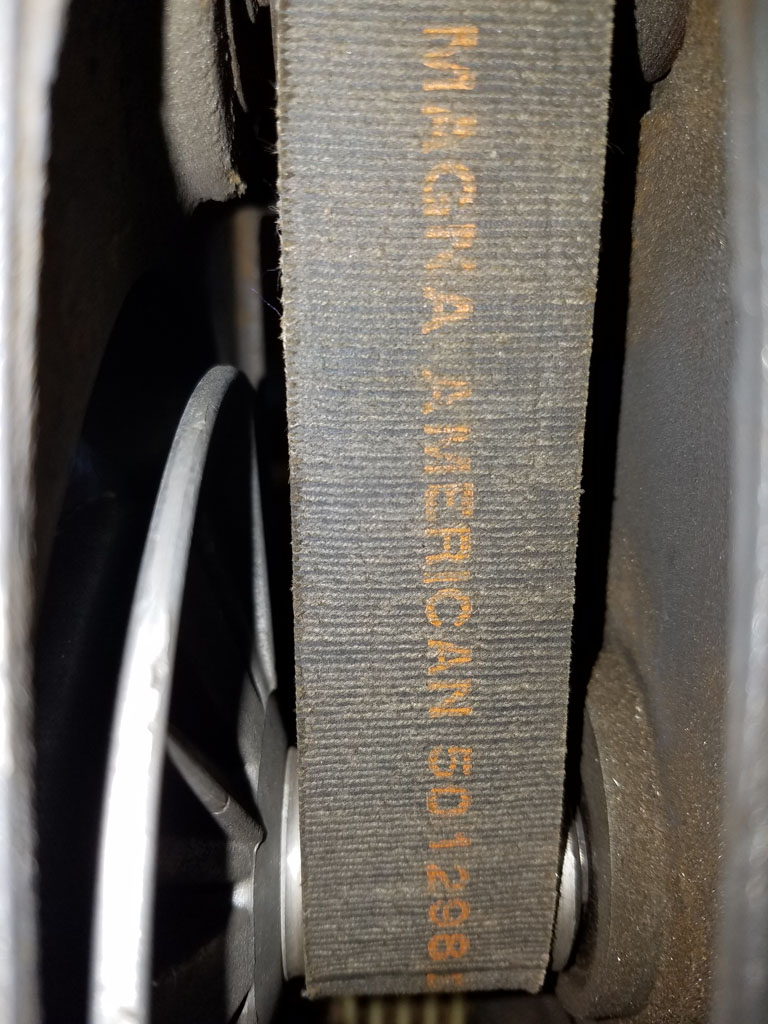

I was chatting with JPG about my Mark VII motor belt, and he thinks it COULD be an original belt. It has "501330 DF" written on it.

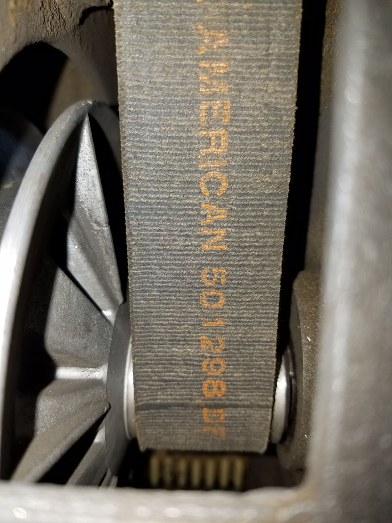

After working on my SS tonight I thought I'd take a closer look at the Poly V belt too. My Poly V belt has to be an original because it says "Magna American" right on it! It also has a model number on it and it reads "501298 DF". That's very close to the motor belt's part number. This isn't proof that my motor belt is original, but it sure make sense if it is.
When I do a search using my motor belt's part number I find belts that are 31" x 1/2". This could mean that the Mark VII actually uses this size belt. I am going to order one and see how it compares to my current belt. It'll be hard to know for sure one way, or another, because belts get stretched and worn. However, it might give us a good idea if that's the correct size. If it ends up being right us Mark VII owners will be smiling!
I'll give an update once the new belt comes.

You're right, it absolutely could be coincidental. However, it seems awfully coincidental that searching that belt number brings up belts that are that close to what the Mark VII needs.
My Poly V belt does cover the entire pulley, and like I said it says "Magna American" right on it. So, there is no doubt my Poly V belt is original. The fact that their model numbers are so close 501330 DF / 501298 DF makes me think that both are in fact original belts.
That being said, I can't prove the motor belt is original because it doesn't say Magna American on it. However, there are a LOT of coincidences pilling up making it hard to disprove it.

Here are a couple of pics of my poly v belt.
Also, I ordered the motor belt, and it should be here next week. Once it gets here I'll take pictures of both the old belt, and new belt. I'll also measure both belts to see how they compare.
