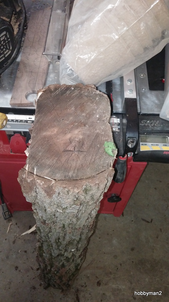

Guessing it will take a couple years in the attic to dry out .
Walnut log cut last fall , was still dripping wet inside after 3 months laying out side .

That appears to be a 'limb'. Internal stresses may be a problem later.
Re: ready for the attic
It was actually the trunk of a younger tree , the top looked to have been struck by lightning ,,,,there was some wind damage , I am{{ hoping }} the stress wont be so bad ,,,You are right on the stress part ,,it can be a pain to work around .

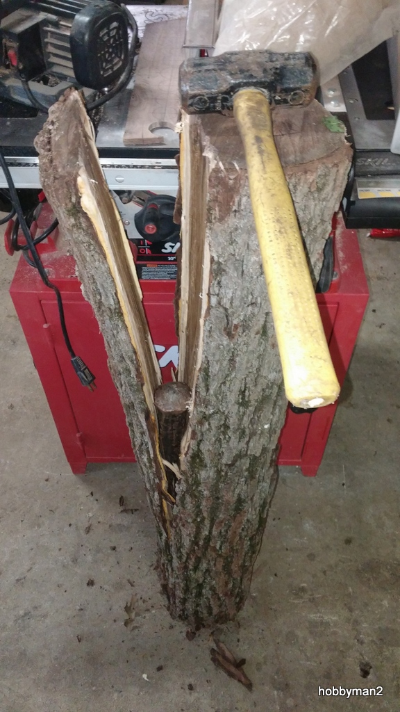

The grain is fairly straight with few if any knots so with any luck any checking will be fairly straight.
If I can get a few table legs out of it I will be happy.
By quartering it I hope most the checking ,,cracking,, from the heart will avoided ,,,,or at least limited .

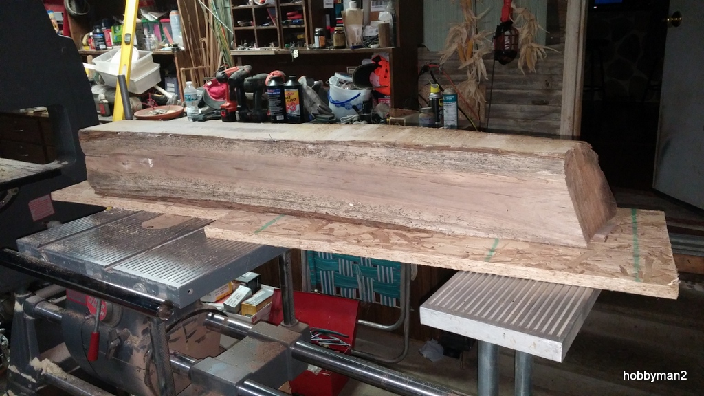

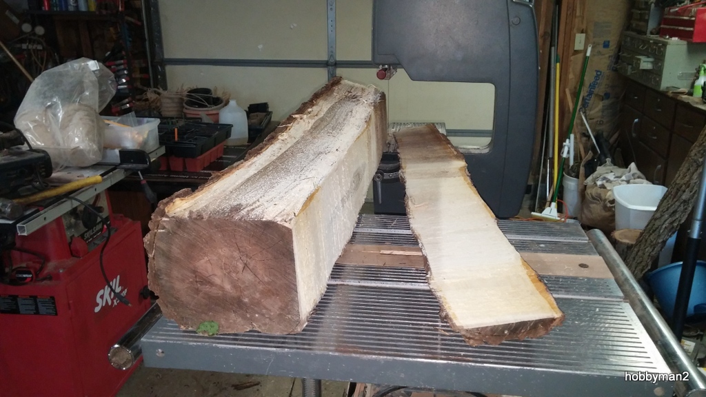

the SS band saw was maxed out , the stock was a full 6 inches .
The saw performed flawlessly with the 3/4 blade.
Once I get it quartered I will post a few more pictures , I can only do so much at a time for a few more weeks do to the shoulder .

3/4 blade?
Wasn't aware the SS band saw would take 3/4.
by golly your right Gene,, I had to go look , it is a 1/2 inch blade .
I must have 3/4 on the brain for some reason.
Well darn. I was hoping you had found a way.
I have the SS branded 5/8" blade on mine right now. Works really well for straight sawing only.
