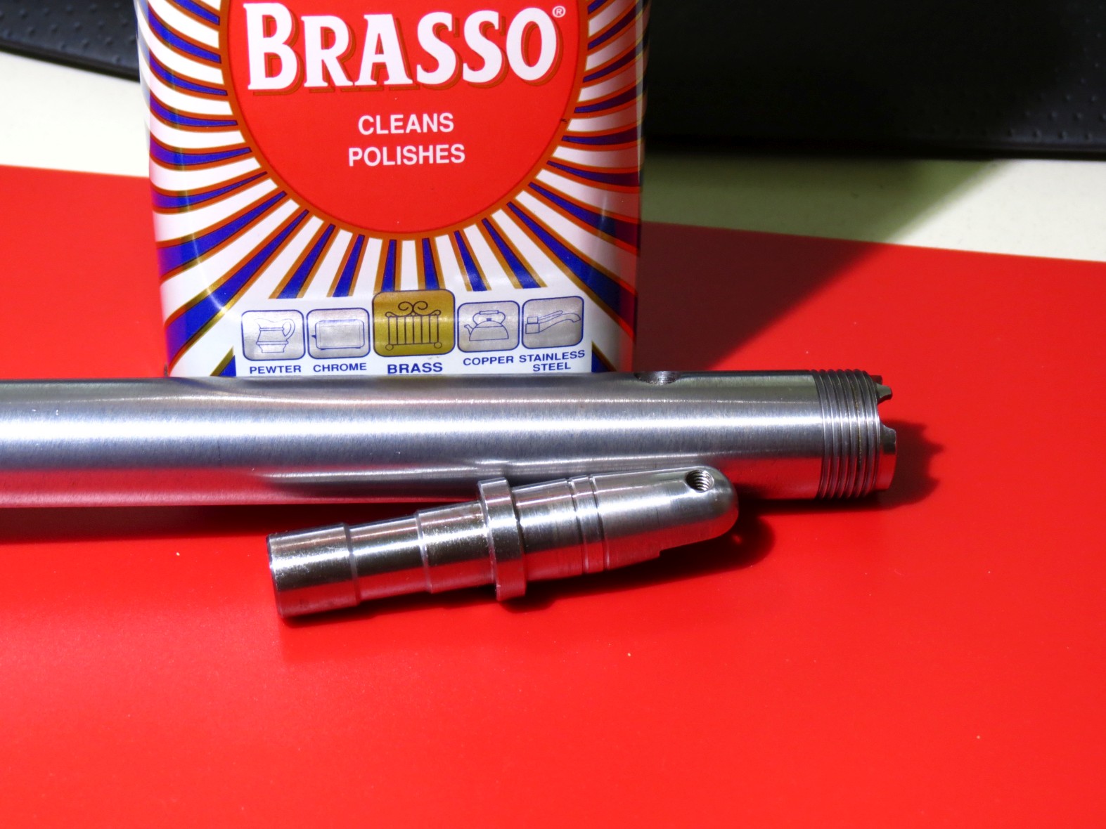

Re: Robert Sorby Turnmaster
reible wrote:....
The only issue I have found is that the last time I used the tool on some wet wood I did not get it clean and dried properly and now have corrosion on the head. A lot of my tools are stainless steel and so this is not a problem.
Now I have to see how well it cleans up.
It cleaned up nicely!
Enough said.
