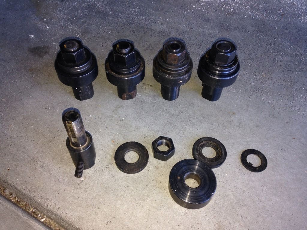

I bought a shopsmith Mark V, 1982 model,
came with some things but i don't know what they are...
anyone know what these things are/do?
I am new to forums so I hope the link is acceptable. There are two photos linked.
http://i1339.photobucket.com/albums/o71 ... gsnswc.jpg
http://i1339.photobucket.com/albums/o71 ... eqoxua.jpg
Thank you in advance
G

The first picture is molder/dado arbors. In the second picture the bottom item is a saw blade arbor for Shopsmith blades that have a 1 1/4" arbor hole. The top item is a #2 Morse taper arbor that fits in the tail stock and is used to mount the drill chuck.
Re: help identifying these items
Arbors = for mounting circular discs to the quill shaft. saw blade. grinding wheel shaper cutters. The 'correct' one must be used appropriately.
Tail stock arbor adapter = typically used to mount the drill chuck on the tail stock.
They all look the same to me. BEWARE the too long set screw(not good!!!!).
:o Missed the arbor in the second pix. :o Tis as John said.

Thank you all, I wondered about that set screw too. I appreciate the answers.
