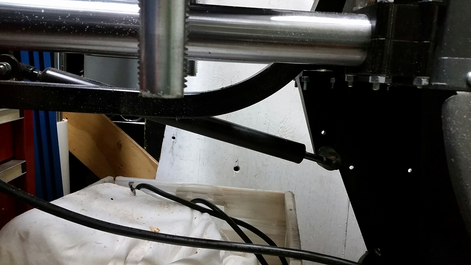

When I first got mine I thought I'd leave it on 100% of the time. Well that didn't last long. I made up some spacers so that I could take off the lift and put it back on in the same location and would not have to fiddle with readjusting.
On my machine I loose 2-1/2" of tube length. Yours may vary from this.
Below the issue is more complex. Here is a picture:
As you can see the amount of space need varies. I would say from some where near 2-1/2"-3" to near 6" on the end near the legs.
Lathe work is effected, cutting at certain depths at a full 45 deg is effected and the solutions are removal for some of those cases. It still takes time but without the left assist the powerpro headstock is quite heavy. And even if you have the lift and detach it you will still be required to lift again to attach.
The attachment and or detachment is simple. a ball stud on one end and a spring loaded slide on the other. When you first set up you have to adjust to get it to fit nicely or it will be a pain to do. This the reason I did the spacer thing.
