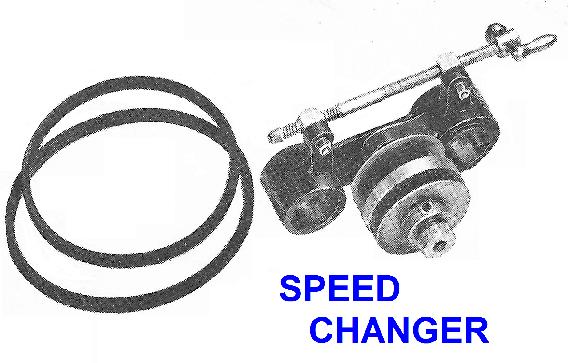

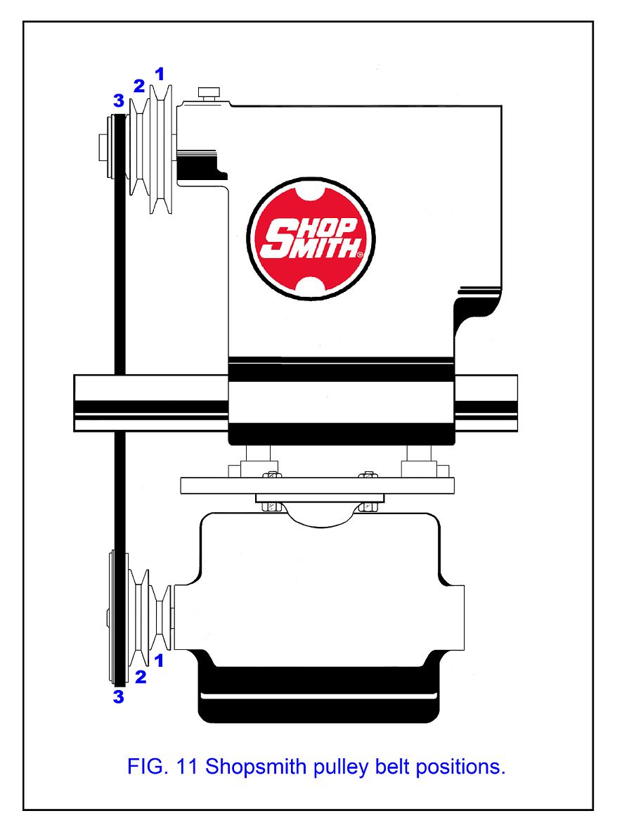

See if this helps based on the basic pulleys. You would be well advised to look at the variable speed changer mechanism if you can pick one up used on eBay as that will allow even further reductions especially helpful for turning bowls on a face plate.
These illustrations came from the Restored 10ER Owner's Guide I did last year.
Everett

Thanks, Everett--very helpful. Between Dick's help and yours, I know what RPM's i'm looking for, and which pulley to use on the headstock...
But...
Still looking to know which pulley I should be using on the motor.
Posts: 6585
Re: Adjusting speed for lathing on a 10ER
doughpat wrote:Thanks, Everett--very helpful. Between Dick's help and yours, I know what RPM's i'm looking for, and which pulley to use on the headstock...
But...
I am confused. You have to use the motor pulley in line with the head stock pulley. In Everett's post, 3 to 3, 2 to 2 and 1 to 1. You can't skew the belt between the pulleys. That gives you 3 speeds, 850, 1725 and 3450 RPM. If you get a speed changer as Everett suggested you have infinitely variable speeds from 425 to 6800 RPM.
