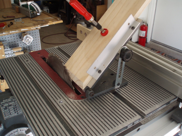

Then the next suggestion from me would be to drag out and tune up the bevel master.
CAUTION: The blade is set too high in this photo of the Bevel Master at work.

Thanks, Dusty. Never heard of a bevel master.
