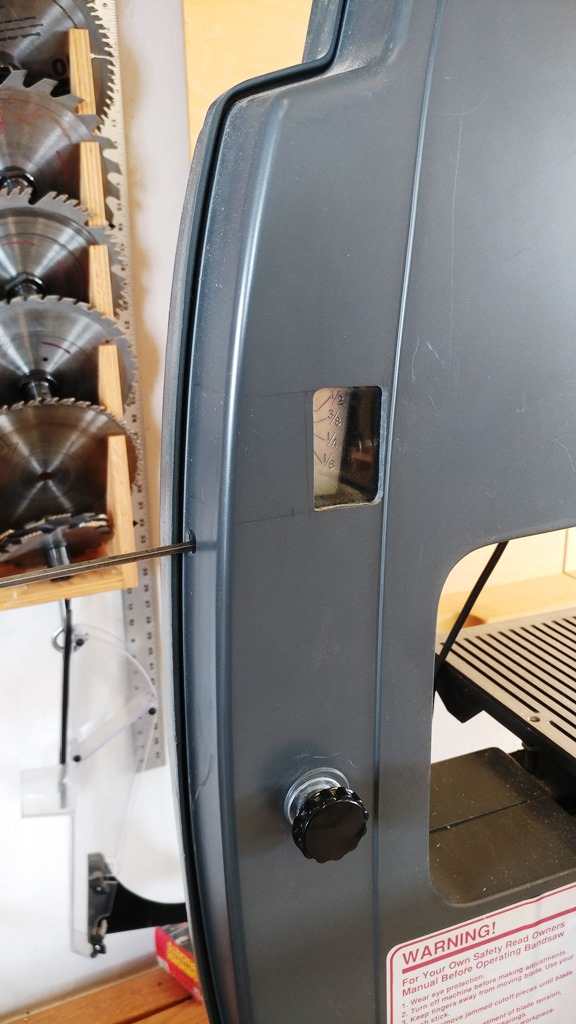

Re: idea for the band saw to ponder
That is how the new covers are. I suspect many have done it. I modified mine right after SS came out with the new design. I am about to walk out of the house but will post a picture when I get back.
Here is the picture of how I modified my band saw cover. I used a piece of plexiglass for the window and glued it on the inside with super glue. It has been there for 15+ years with no problems. It is absolutely a worthwhile mod.
- 20170518_141034_Burst01.jpg (144.12 KiB) Viewed 18908 times
Looks great, John. I may have to try that also.
