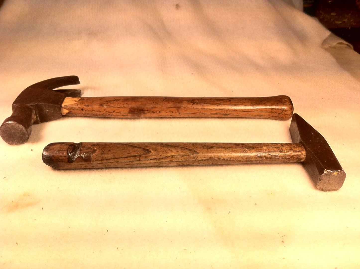

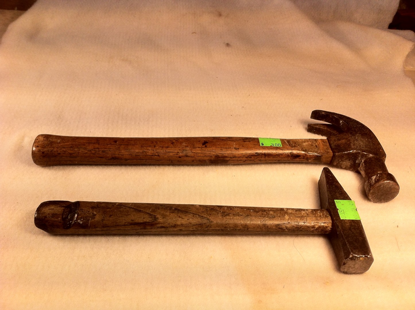

These are a couple of old hammers that I have bought recently at the local ReStore.

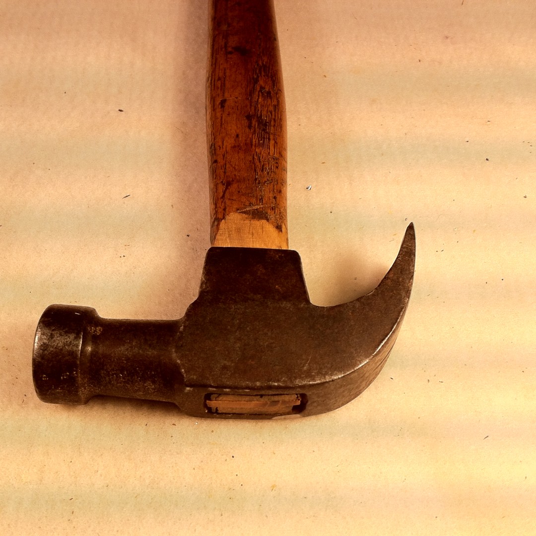

This spring I read The Anarchist,s Tool Chest by Christopher Schwarz. One of the tools he recommenced was this older style of claw hammer with a pronounced curve to the claws, so when this one turned up for $3.00 I pounced on it.

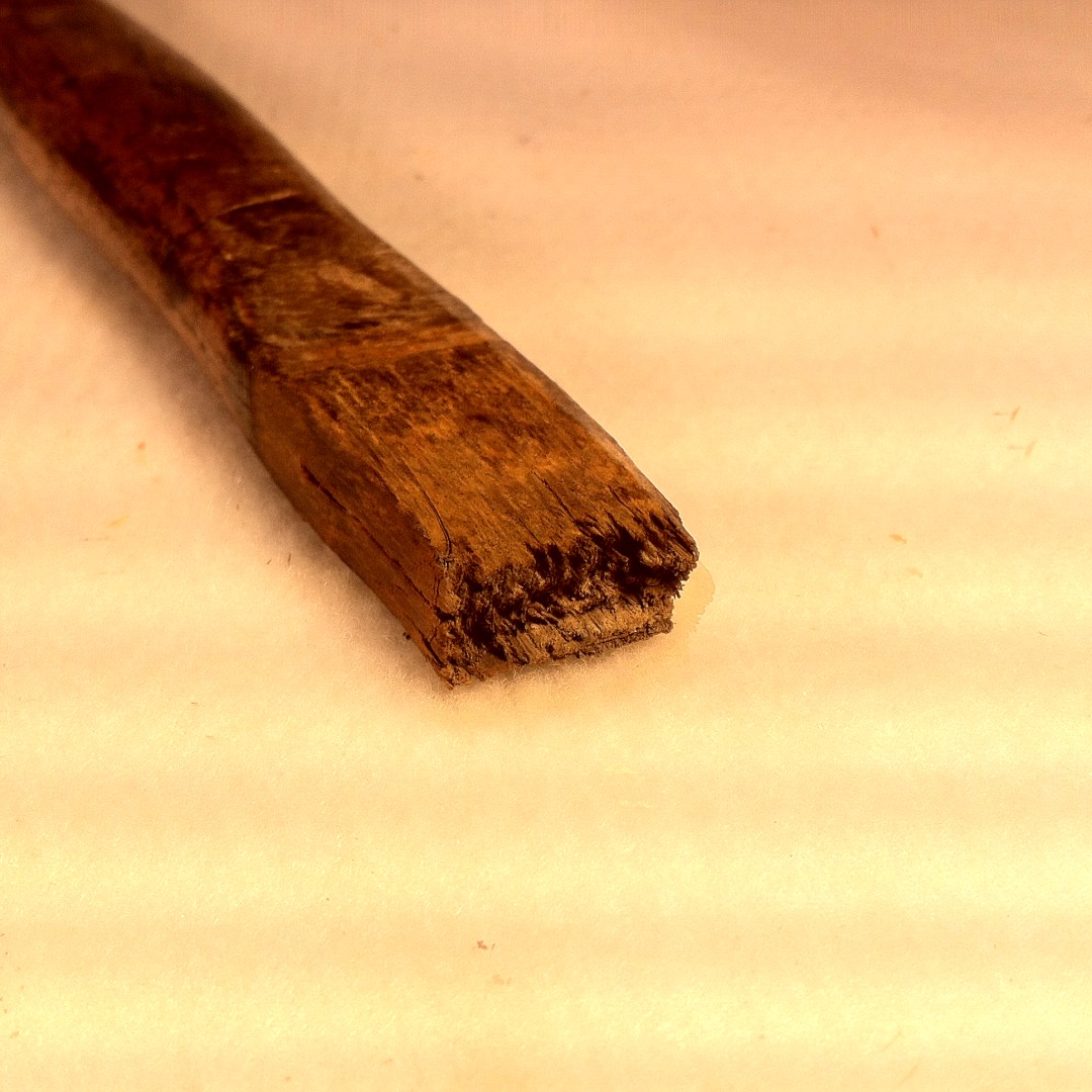

I am not sure the handle was original to this head but it is old, The end in the head was all ragged (rotted away?), had no wedge, and only went in about half way. On the plus side was worn very smooth and felt good in my hand, and there was enough length that I felt it could be re-fitted to the head.
So I sanded oft the bad end till I got to solid wood, fitted the handle to the head (strip sander again), ran a jigsaw blade through the slot to clean it out and cut a wedge from some scrap hardwood (bandsaw to the rescue), and reassembled it.
To finish it I wiped both of the hammers (claw, and cross peen) down with solvent and wiped on a coat of Watco Oil.
I used the claw hammer quite a bit today, pulling nails from reclaimed wood so I could store it properly and free up that end of the shop. I was impressed that it seemed to be able to pull longer nails than the style of head I am used to, without having to use a piece of scrap wood under the head to increase the lift. :)

I have a hammer like the bottom one. I've heard it called a tinner's hammer which I believe means it is for sheet metal type work. Mine came from Uncle Walter, who was later my grandfather but that is another story. My Mom got his tool box when he died but it was pretty picked over by then and further losses as other tools got loaned out and not returned. I did manage to get a few things out of it for myself but it would have been cool to have it intact.
