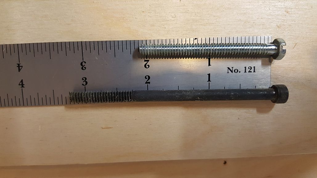

My thread gauge says it is a #10-24 for both the 510 and 520 versions with different lengths. I can measure the lengths if you need them.

yes, please.thunderbirdbat wrote:My thread gauge says it is a #10-24 for both the 510 and 520 versions with different lengths. I can measure the lengths if you need them.

The 510 is 2 1/8 in long and the 520 is 3 1/4 in long.
