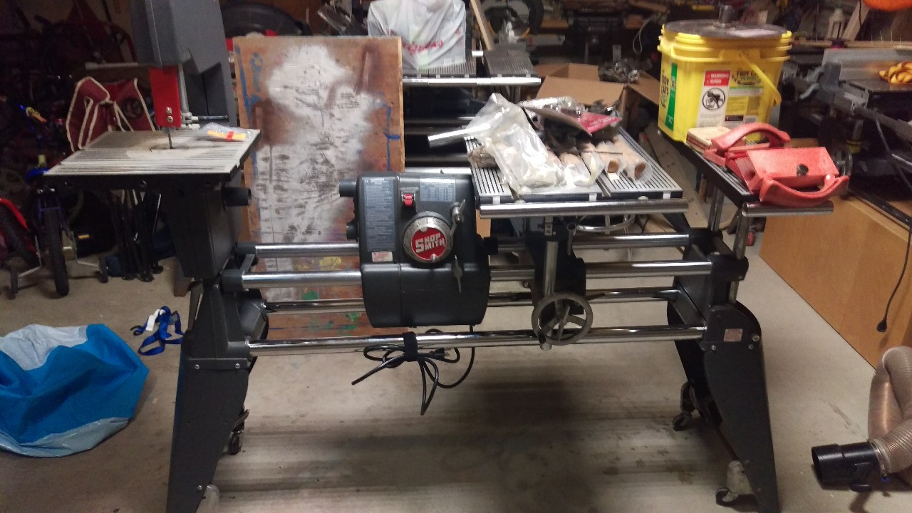

The dents are minimal but still appear to me. Here is a picture of the recent acquisition. As you can see, it's in really nice shape but I do see the minor dents. I'll see if I can get better pictures. Still, not a bad haul for $350 with bandsaw. It's a 2008 with items like the lathe tools, drill chuck, drill bits, and a few other items never used and still in the original packaging.
I will see if I can get a picture of the dents to see if it's actually a worry
-Beave

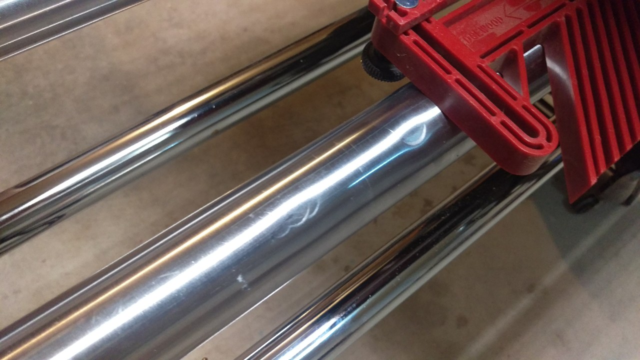

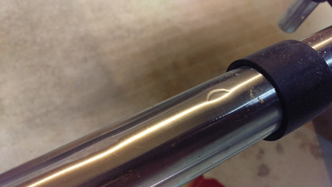

Here are some close ups of the dents. I doubt they bent the tubes but there are still dents
-Beave

I did that on my '07 510 about 6 weeks after buying it, getting paranoid on headstock lock tightness with some overhead routing in drill-press position. Then I rotated the tubes and lived with the (hidden) dents several years. Around 2010 I put a different set of tubes on the machine.
Somewhere I remember that Nick recommended positioning each tube so that the 'bow along the length' was highest in the middle. So turning them 180 degrees from that might not be the ultimate most accurate setup.
Chris
ChrisNeilan
Posts: 1463
Re: Way tubes
Post by ChrisNeilan »
If the headstock does not bind and easily slides over the area wear the dents are i would live with it. If it catches even slightly replace them.
Chris Neilan
