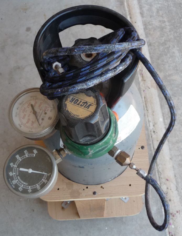

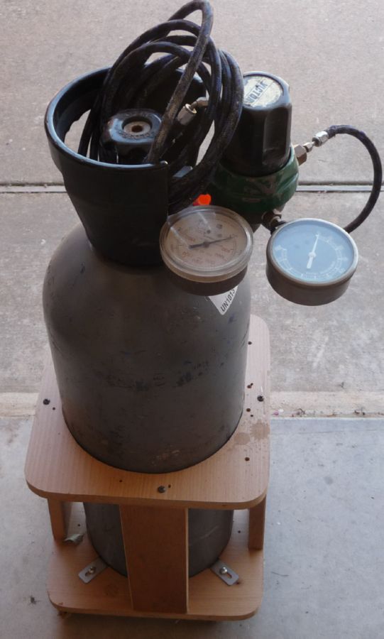

Some recommendations:
Many tanks for sale are used by paintball players; hence they are aluminum and don't hold a lot of co2. Mine is 20 lbs vs. 5 lbs and refill is $10 with no charge for exchange. A tank test usually runs $25 so the exchange is the way to go. Check on prices. If they charge for an exchange look elsewhere. Buy the larger tank if you have the space. Build something to hold it with wheels so it doesn't tip over. You can't damage these things unless you drop them.
The regulator on mine was purchased used in 1984. USA stuff seldom if ever fails. You might have to pay extra for an aluminum exchange (or not). Older steel is fine. I'd stay away from HF for regulators. Try used from a gas supplier or look online.
- a1.JPG (101.39 KiB) Viewed 10601 times
- a2.JPG (71.05 KiB) Viewed 10601 times
