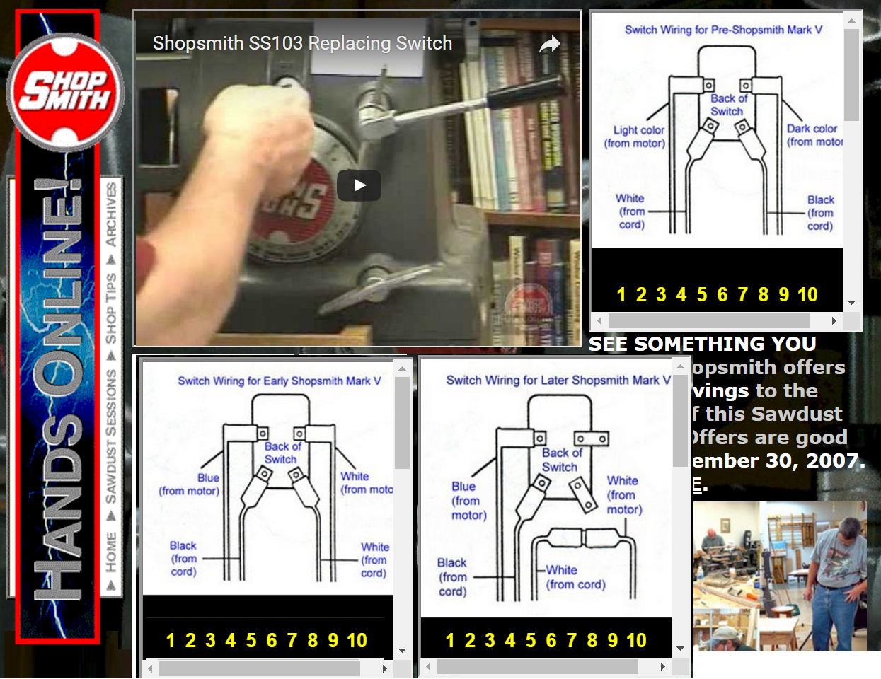

It might be prudent to replace the power switch and the power cord while you are replacing the motor as they are vintage parts that degrade.
There is a different wiring schema used in the newer motors that pigtails the white (neutral) leads together, and routes ONLY the black and blue (hot) wires to the switch.
When you get your motor, it will likely be the new wiring set-up. I have attached a file that will help visualize the connection types through the years as explained in one of the Sawdust Sessions.
Hope this helps answer any questions that might come up.
Everett
