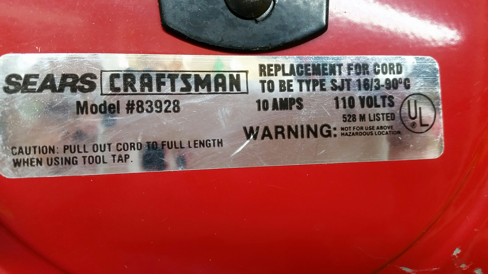

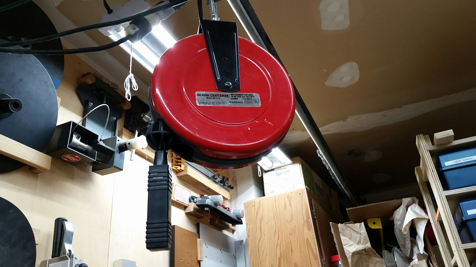

I purchased a retractable cord reel at a garage sale. It was rated at 10 amps. and after some use it is not sufficient. I replaced the power cord on my 510 with one that came from a Mk. VII (either 12/3 or 10/3)and now I will replace the cords for the reel with 12/3 and keep the run much shorter. I have three questions:
1) Do I use dielectric or silicone grease on the rubber rings? Pics 1 &2.
2) I installed a 3 outlet connection (unknown gauge). Pic 3. Can I replace the single outlet on the 12/3 with this?
3) I have a small 8 amp remote switch that will just plug in to one of these connections and a much larger 15 amp. Can I use the 8 amp?

I'm not an electrician, but I always assume the safe capacity of any wiring is the capacity of the weakest link. If the reel was made for 10 amps and you're still using the stock wiper contacts, I wouldn't assume you're good for 20 amps if you're just replacing the cord itself with 12/3. Same with the three-way. If you're splicing onto the old wires leading into the plug, you only have a 12/3 system if you're 12 gauge all the way to the internal sockets.

Weakest link indeed! That be the thing you want to grease. Most likely that is where the 10A rating came from.
I am guessing the original wire was #18. Surely no larger than #16.

I use one of these cords in my shop. It is rated at 10A but you also have to have all the cord pulled out at the time. I use it only for things like my soldering station or dremel tool.
Here are a couple of picture of it for reference:

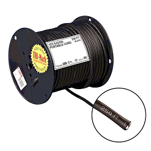

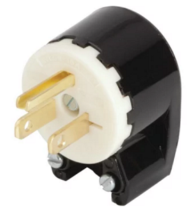

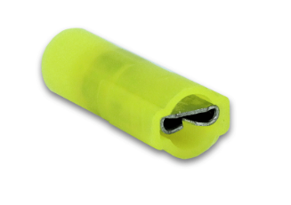

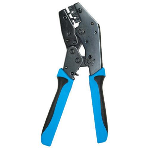

My advice is to use 12/3 wire (which you can buy by the foot), installing your own 15A Heavy duty plug such as a Hubbell 15 Amp U-Ground Angle Plug, no longer than 10 ft. then strip supply lines back from that length, using a properly sized strain relief as others have stated on the motor pan.
Use new push on insulated terminals, crimped with a good crimping tool.
Examine the wires to the motor itself and consider your options if they are in poor condition. Some are more readily serviceable than others based on which motor you have.
Ensure the receptacle itself is in good mechanical shape, not worn out from years of use, fed ideally from a dedicated isolated circuit, with a ground fault interrupter circuit breaker.
You will not have problems. Period.
ratcheting crimping tool.png (53.95 KiB) Viewed 6573 times

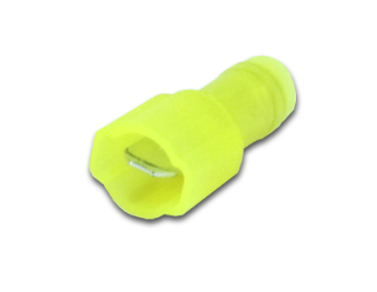

UPDATE: I should have mentioned that one needs to select the proper size crimp terminal connectors. Colors designate the AWG Gauge of Wire the connector is compatible with. 12/3 will require the Terminals that are insulated with Yellow. See Below:
Wire Colors - AWG Range.jpg (29.8 KiB) Viewed 6499 times
Scotchlok Female Disconnect 12-10 AWG Fully Nylon Insulated.png (36.15 KiB) Viewed 6499 times
Scotchlok Male Disconnect 12-10 AWG Fully Nylon Insulated.png (34.87 KiB) Viewed 6499 times
