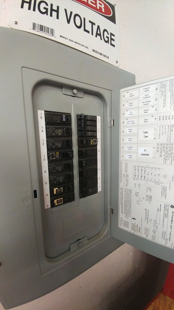

Thanks JPG and Videobear. My panel in the shop is run from my house panel so there is no main breaker in the shop just in the house. Can I still use the whole house mentioned above in my shop electrical panel?

Are you telling me your shop is in a building different from where the breaker panel is and there is no breaker/panel in the shop?

I would hope that the "Sub-panel" would have a main breaker on it. AND a very heavy gauge wire feeding it. Preferably 8 ga.....

ANNND an independent ground!

To quote claimdude..."My panel in the shop is run from my house panel so there is no main breaker in the shop just in the house."JPG wrote:Are you telling me your shop is in a building different from where the breaker panel is and there is no breaker/panel in the shop?
Mine is the same way. The shop is fed from a 60 amp breaker from the house. There is no "main breaker" in the shop panel. The shop is fed under underground from the house with 6 gauge (maybe 8 I don't remember). It was installed by a licensed electrician. I wired the shop myself.
The picture shows the shop panel.
- 20170726_193915.jpg (137.13 KiB) Viewed 9377 times
Re: PowerPro 220v surge protector
IIUC he said he had no panel at all.

Well, I'll be a monkey's uncle! Mine is wired the same way. I could swear there was a main breaker on the panel in the garage- nope!jsburger wrote:To quote claimdude..."My panel in the shop is run from my house panel so there is no main breaker in the shop just in the house."JPG wrote:Are you telling me your shop is in a building different from where the breaker panel is and there is no breaker/panel in the shop?
