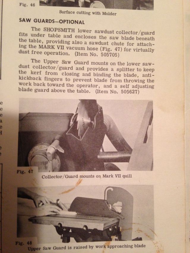

Hello,
The saw guard that came with my Mark VII looks very different from the others I have.
It doesn't have a full front guard--just like weird side and lower guards.
Is this normal or is it missing something?
It honestly looks like this is how it was manufactured.

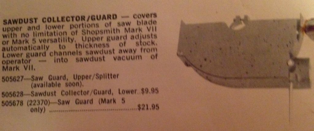

The one shown in your picture is the upgrade to the Mark V system seen here http://www.shopsmith.com/ownersite/cata ... system.htm There were at least two optional saw guard at the time of the Mark VII; one shown in the operator's manual and one in the Magna accessory catalog. Lower shop is a mess :o
This style I have on a Greenie was shown in the Mark VII operator's manual attached to the Mark VII.  This doesn't have the original clamp but was repaired.

This was received on a Mark VII that was repainted Dark Green.  Note the part number is not the same as the one in the Magna accessory catalog but it looks the same.
The gray one is the same part number as the dark green although the numbers are upside down.  The upper guard is also shown.
Magna Accessory Catalog shot

From the Mark VII operator's manual

Thanks for the info!
This was the only guard that came with Mark VII when I got it.
I didn't realize the Mark Vone would fit.
I got metal guards with some of my Mark Vs and larger
Plastic ones (for the 12"--this just fits the 10" blade) with others
I don't see a problem using it on the Mark VIi--is there
A problem I should know about?
