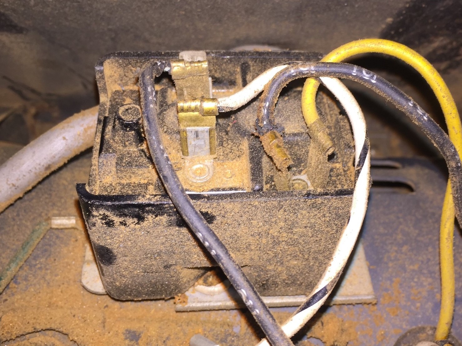

I can confirm the wire routing is as described.
However I can also confirm there are difference in the wire colors from the relay to the switch.
From relay terminal 2 to switch terminal 2: SOLID BLACK, LABELED WITH WHITE UNDERLINED "2"
From relay terminal 5 to switch terminal 5: SOLID BLACK, LABELED WITH WHITE UNDERLINED "5"
That's cool, at least those two connections are idiot proof.
I assumed these wires are original, they certainly look like 50+ year-old wires!
If so, please accept my minor editing contribution to Everett's manual.
Photo attached. (hopefully)

- Start Relay AO SMITH (2).JPG (465.45 KiB) Viewed 10417 times
Re: Bypassing switch + relay to test an A O Smith motor/relay
Note that Everett mentioned that wire colors may vary. He specifically mentioned the 2 to 2 wire.
I surmise the use of wires that were intended for use with other makes of motors were used as they were 'available'.
The important thing is the wires consistently go the same places.
Also realize our sample size is very small and that there were errors in published manuals. Everett's manual contains the best we can conclude regarding them.
P.S. Your start relay appears to be different from those previously seen.
