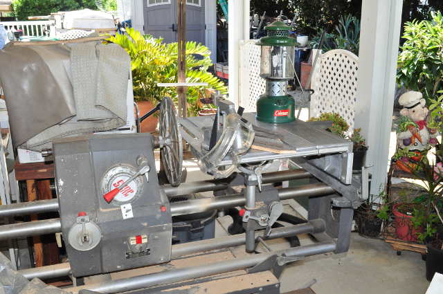

- Here is a quick picture of the machine.
- DSC_6872.JPG (67.01 KiB) Viewed 15042 times
