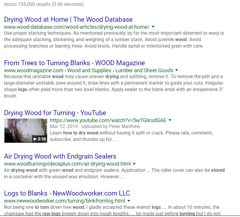

Where did you search?
Google found 735,000 results in less than half a second.
The second one from Wood Magazine seemed pretty good.
storing and drying raw logs for turning.png (163.48 KiB) Viewed 11639 times
