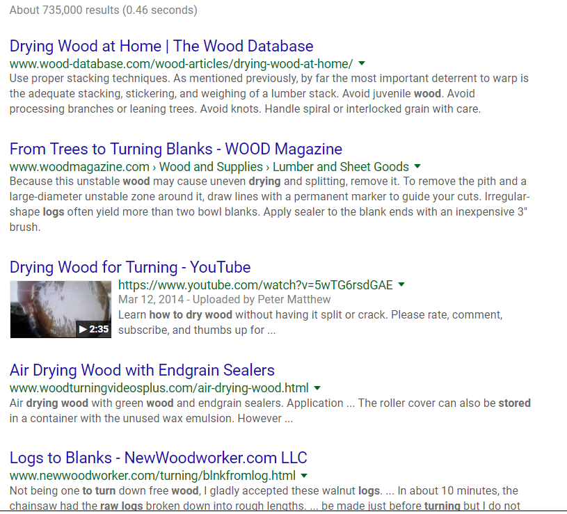

Where did you search?
Google found 735,000 results in less than half a second.
The second one from Wood Magazine seemed pretty good.
Everett

everettdavis wrote:Where did you search?
Everett
I usually go to he Internet when I want general information I can trust fully. In this case I only searched the best source, this forum.
