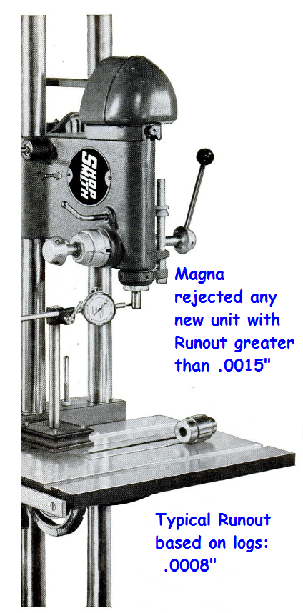

Either you have worn bearings, the wrong bearings (perhaps both) or an extremely acute sense of movement based on what Magna Quality Control on the 10E and 10ER Runout measurement allowed. See Illustration that came from Magna Advertising back in the 1940's and 50's.
The Induction Hardened Spindle was machined to .0002 of an Inch, and the original tubular steel way tubes were centerless ground to .002 of an Inch.
Everett
