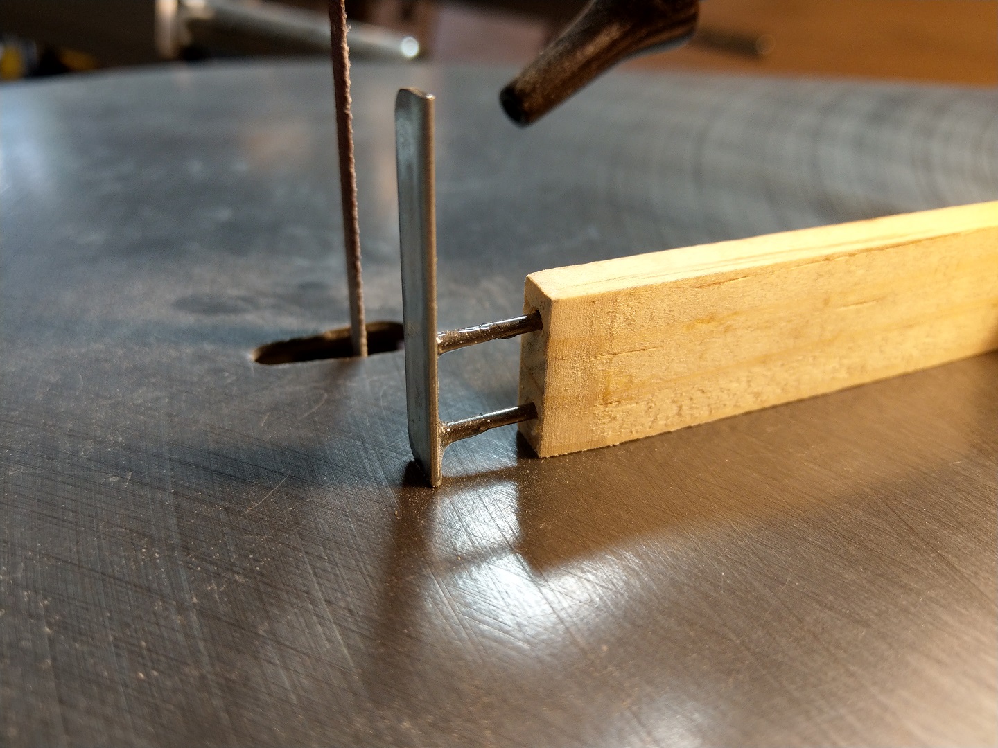

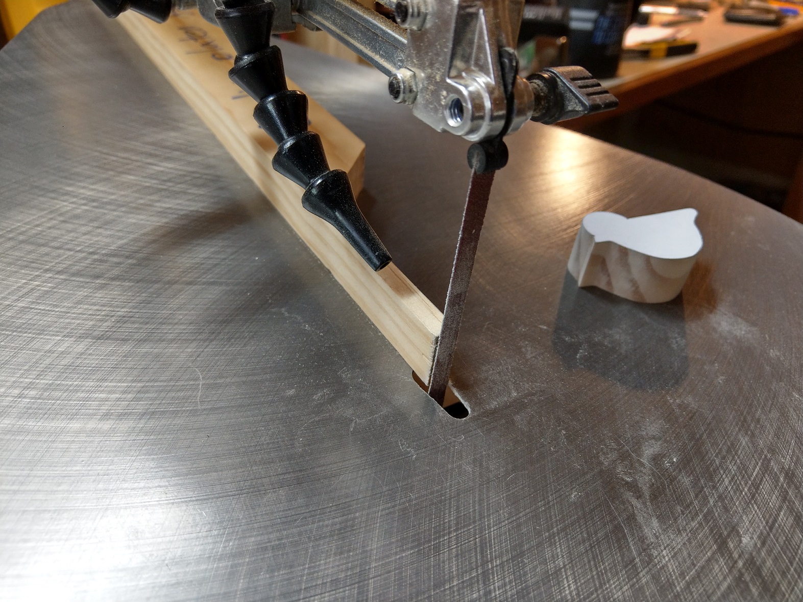

I'm not sure if the ShopSmith Scroll Saw can use these Olson ScrollSander Belts or not.
Not having a strip sander I find these come in handy for small parts. Sanding materials of a generally small thickness(<1/4") works great. When sanding pieces that are 3/4" thick I wasn't getting as good results. The belt was rounding over my edges. Increasing the tension on the belt didn't work, still too much flex in the belt.
I had to create a platen.
It worked well but I wanted more room around the platen/belt to get into tight places.
This worked wonderfully. It isn't perfect but it is a lot better than what I started with, nothing.
