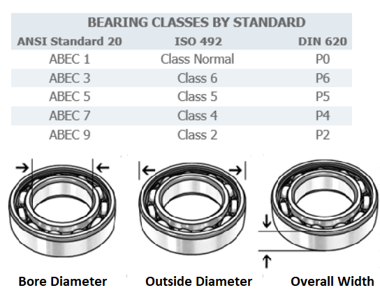

I have attached a few reference images I was assembling toward this project to establish a bit of essential knowledge transfer relative to bearings in general, which would have narratives relative to service, repair, and restoration.
Do you see the same need as we did?

- Deep Groove Ball Bearing Nomenclature - Courtesy of Timken Bearings 2017 - Everett.png (110.56 KiB) Viewed 16321 times
