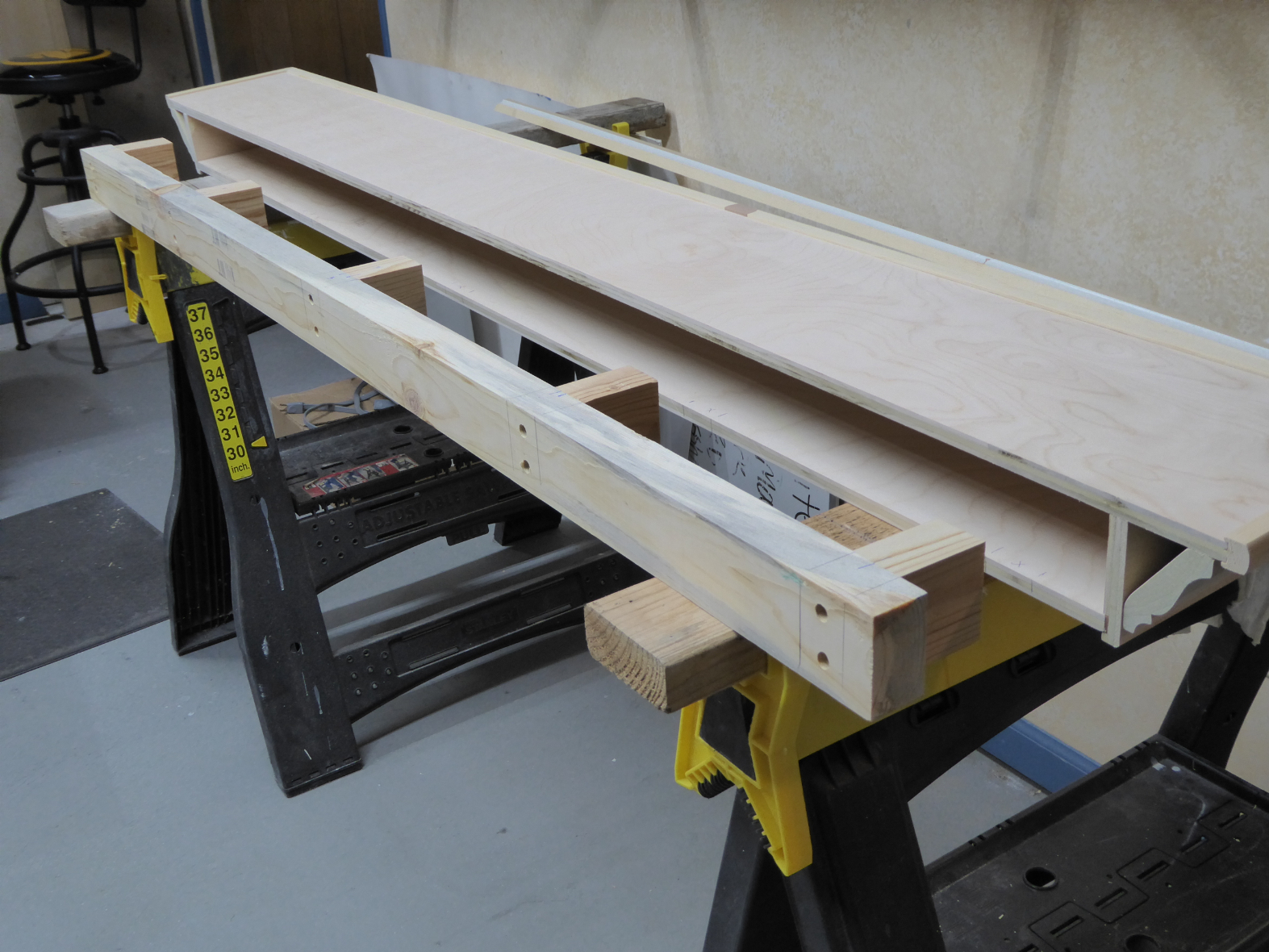

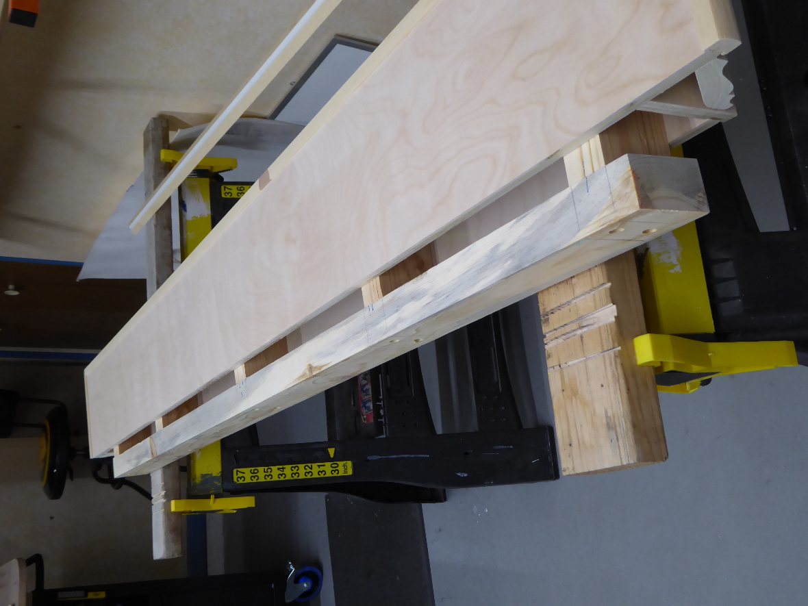

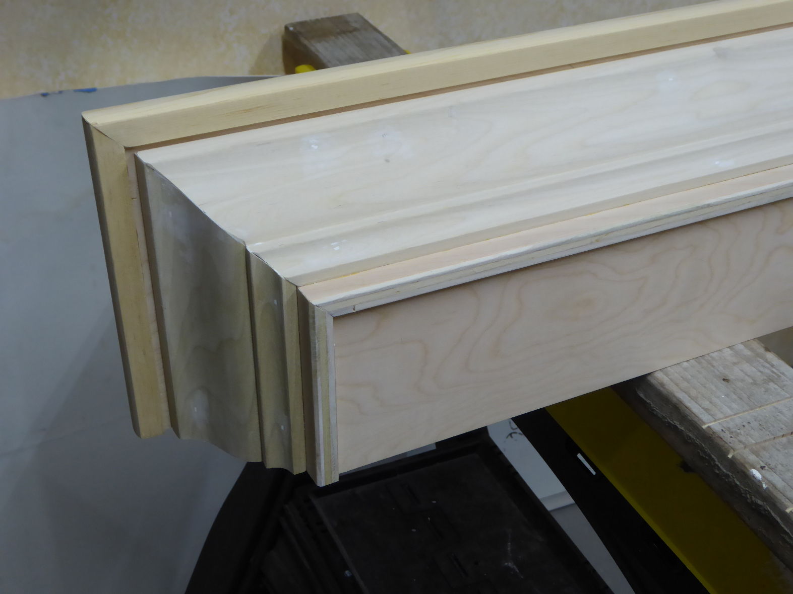

I made a mounting unit from big box 2x4 stock. The shelf slides over the mounting unit, until it's flush against the wall. I'll drill, counter-bore, screw and plug 4 screws through the top of the unit into the mounting fixture. (See pics 1 & 2, viewed from the back left). (The shelf unit is a couple inches longer than the mounting unit. This will allow me to really center the unit in the space when it's installed.)
The shelf carcass is 1/2" pw. A bottom, 2 sides, front and of course the top. No back.

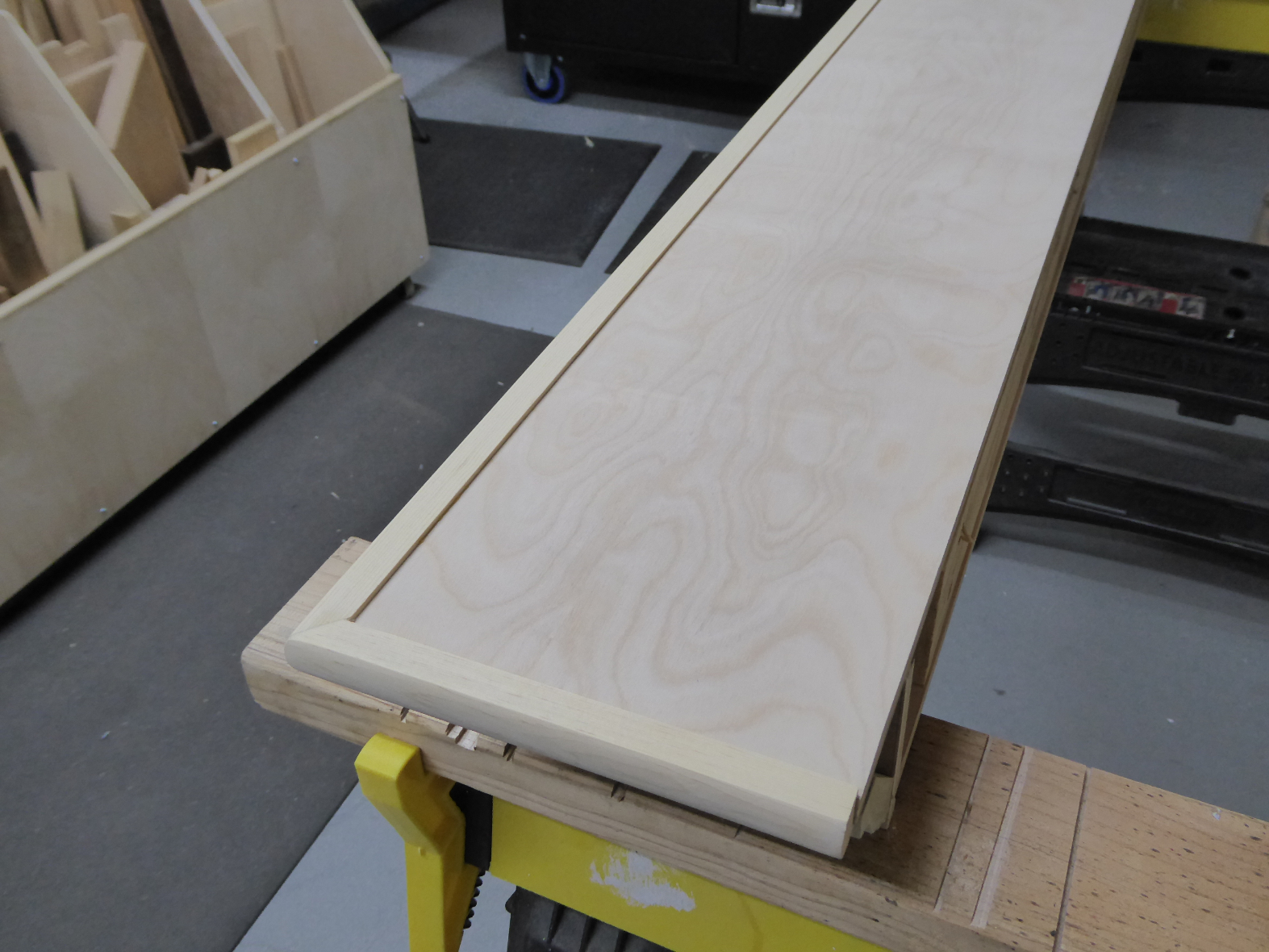

Because the top is pw, I made an edging to go around the unit. I ripped it to size and the routed a shallow groove (1/8") so it wouldn't move around while gluing it to the top. I also routed a bull-nose profile on the outside edge. (pic 3 shows the top and trim molding.

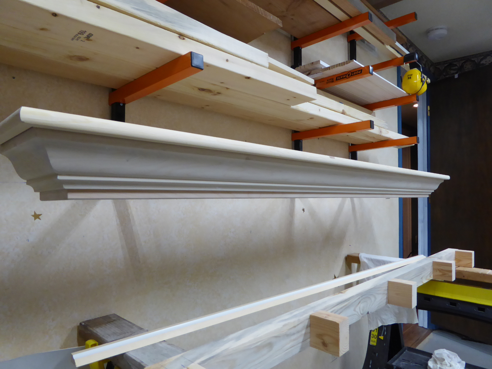

Finally I cut and added the crown molding. I cut the miters on an old hand miter saw. It's just easier to manage than on the SS. The molding was glued and nailed into place. I used finish nailer with 1" nails. You can see the crown pretty well in pic 4. Pic 5 the unit is hanging off a wood storage rack, so you can see the whole thing.

Looks good. That looks a lot like the mantles we would fabricate and install. Attached the same way. Can't wait to see the finished product installed.

No idea what the couple plan to display on it. I saw their living room and I think their style would be considered 'traditional'. I scrounged thru my old magazines and found 5 floating shelf plans and they picked one from Woodsmith. I changed stock from all poplar to a combination of birch pw, pine, and poplar. I changed the size from 20" to 70" and how the unit is hung. Woodsmith editors used a cleat, I like this idea better because the weight is so far forward. I sprayed on tinted shellac primer yesterday, today is sanding - ugh.

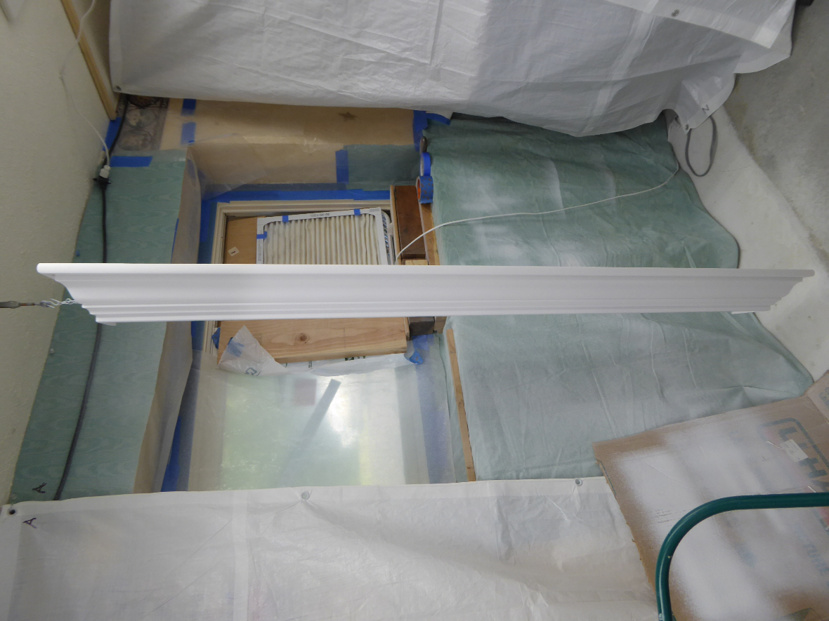

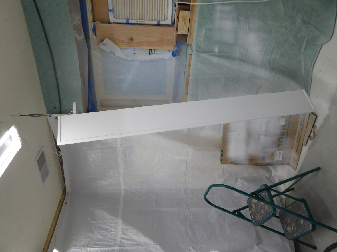

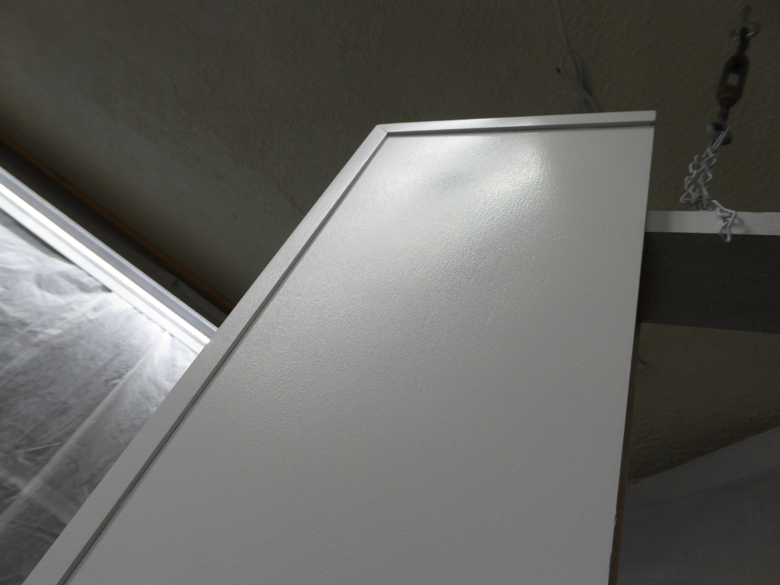

Here are a couple pics of the unit in my workshop, converted to a spray booth. I'm scheduled to install it Saturday. Don't know why a couple are sideways, they were correct in the folder.
