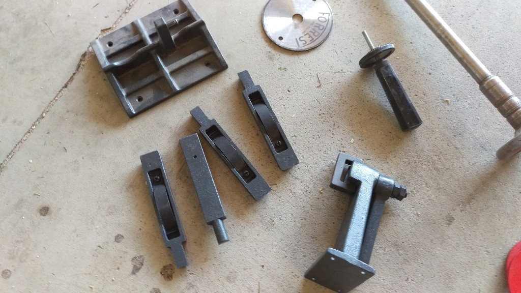

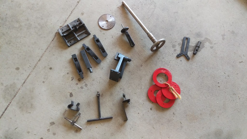

Purchased a lot off Craigslist for the tenon jig, and ended up with a ton of random parts. Can you help me identify these?
Just for identifying purposes it was a 520 with belt Sander, l
Dust collector, mortise and tenon jig, lathe duplicator cutters (not the duplicator), a speed reducer, miter Guage extension, jointer, shop light, bandsaw fence)(not hand saw) and a ton of random parts (I think the original batch was some guy repairing shopsmith items.
Anyways, here it is...
-Beave

I think that the item marked "Forrest" is a blade stabilizer from the folks that make the Forrest saw blades' The red items appear to be insert rings from a oscillating spindle sander or from a router table.

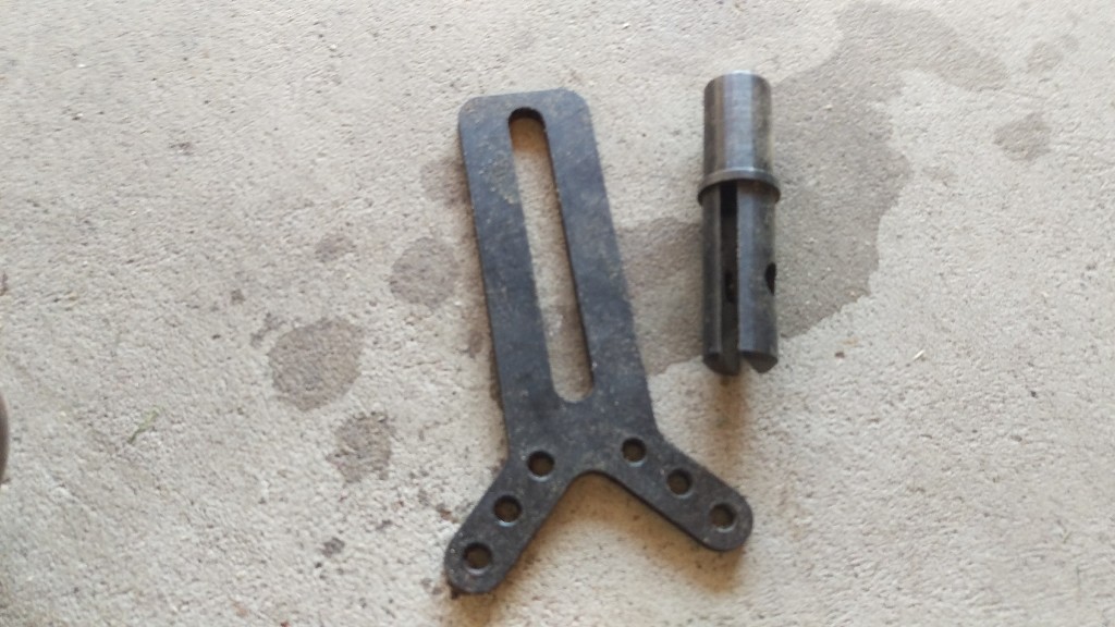

The other items may be from a 10 or a 10ER but I am not familiar enough with the 10ER to make a comment. May bepart of the lathe tool rest system.

The last pic is a ShopSmith steady rest minus the two bearings
