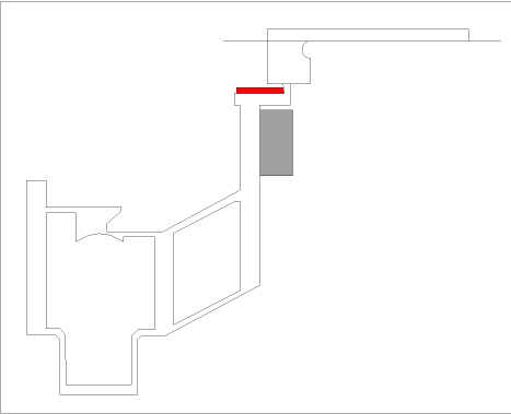

I was working on a sketch of the 520 rails for a project I'm working on and noticed that I wasn't really sure how the alignment should be done.... When the gauge is in position is it sitting on the magnetic strip or is it on the ridge of the rail?
I've got the magnitic strip in red on the sketch and this applies only to the new parts with the magnetic strips...... (Shown sitting on the ridge)
[ATTACH]43[/ATTACH]
set-up gauge position

Set Up Gauge Position
You have asked a very good question and the answer may very well cause me to have to reinstall my front rails.
I have installed mine exactly as you have depicted in the above drawing. As a result, the bottom edge of my rip fence is not parallel to the table tops; it is about 3/32" higher in the front edge of the table than it is at the back edge of the table.
If the alignment gauge had been used in such a way that it contacted the front rail surface where the magnetic tape rests, the gap between the rip fence and the table top would be closer to equal when measured at the front and then at the rear of the table.
The rear rails are mounted correctly.
Does it really make a difference? I am inclined to say NO. The rip fence alignment is not affected and the 'fence lock' mechanism operates properly.
However, I am almost certain that I will end up reinstalling the front rails so as to obtain a near parallel relationship between the rip fence bottom surface and the table tops.
