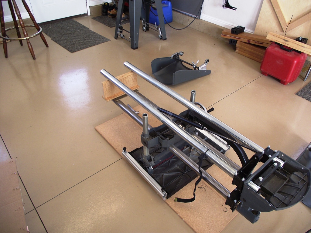

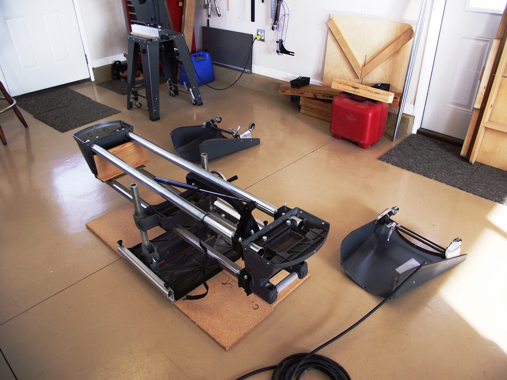

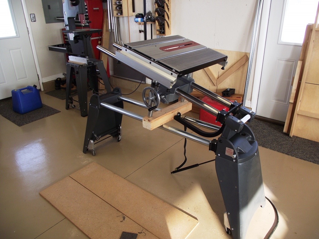

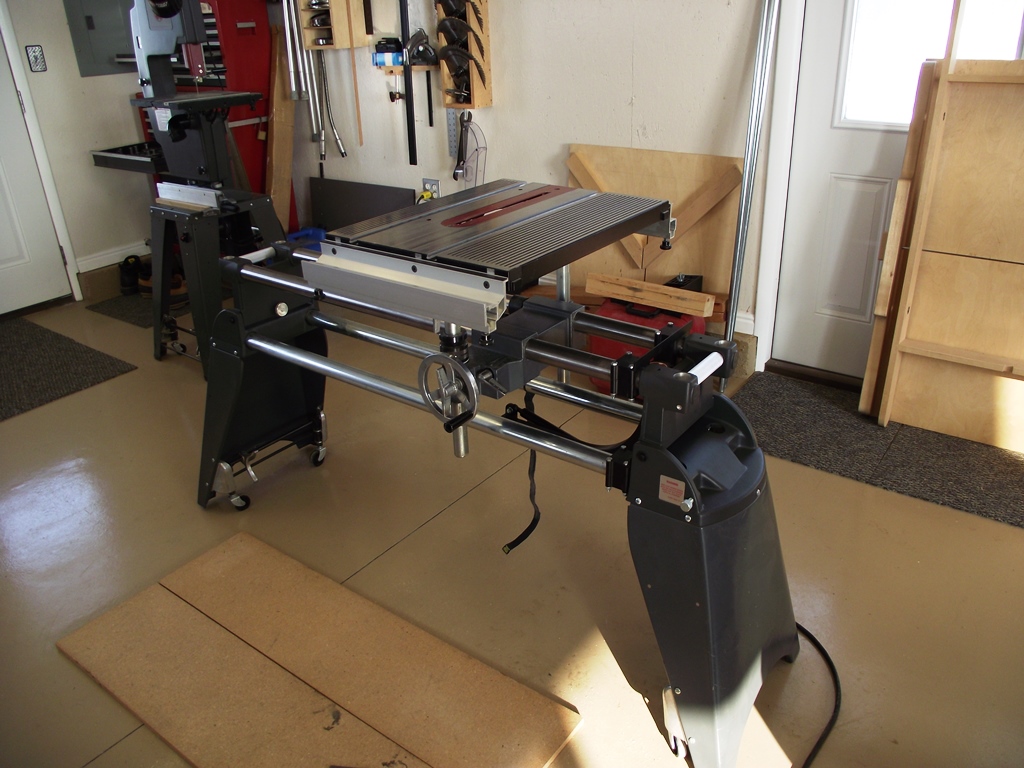

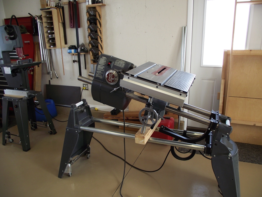

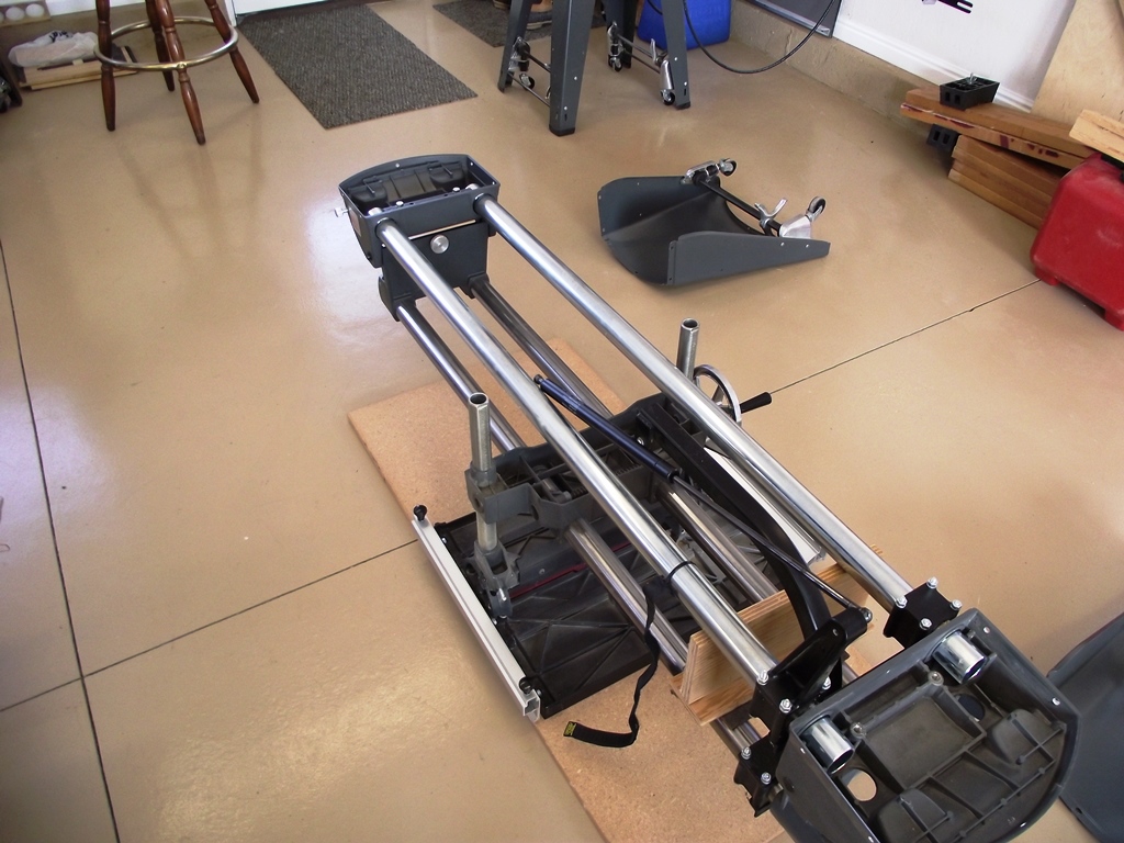

This is what I did. I had a 520 that I upgraded to a double tilt Power Pro. Follow the Power Pro and double tilt instructions. The Power Pro upgrade is just removing and replacing the Head stock. The double tilt instructions require removing the head stock so just follow the double tilt instructions and install the Power Pro head stock when you are done. The pictures show the procedure described in the double tilt instructions. Do the castor upgrade while the legs are off. Leave the table alone and use it as is to turn the machine over on. The spacer for the tubes is specified in the instructions when you replace the end castings for the double tilt. Once you get the machine upright with the head stock on you can do the 520 table upgrade. The last thing is install the lift assist. You see the lift assist in the pictures but I already had one before the upgrade. You should install it last.

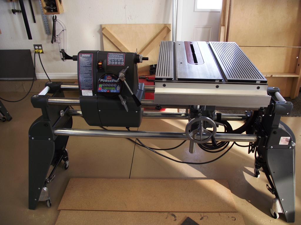

Since my powerpro upgrade project is on hold until shopsmith gets back to me I went ahead and converted my other SS to a shorty. Taking 18 inches off the length makes a world of difference on where I can store it in my shop. The upgraded wheels is a big improvement in manuverability.

Re: upgrading - what to upgrade in what order?
You have the most amazingly clean shop floor!
