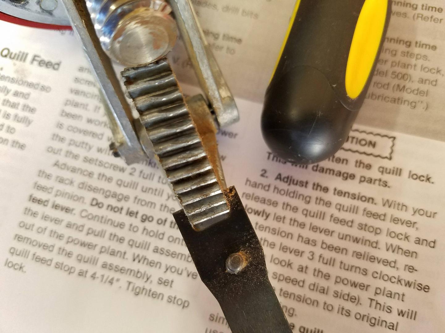

The porkchop teeth look a bit worn, but can be touched up with a file (use a light touch).

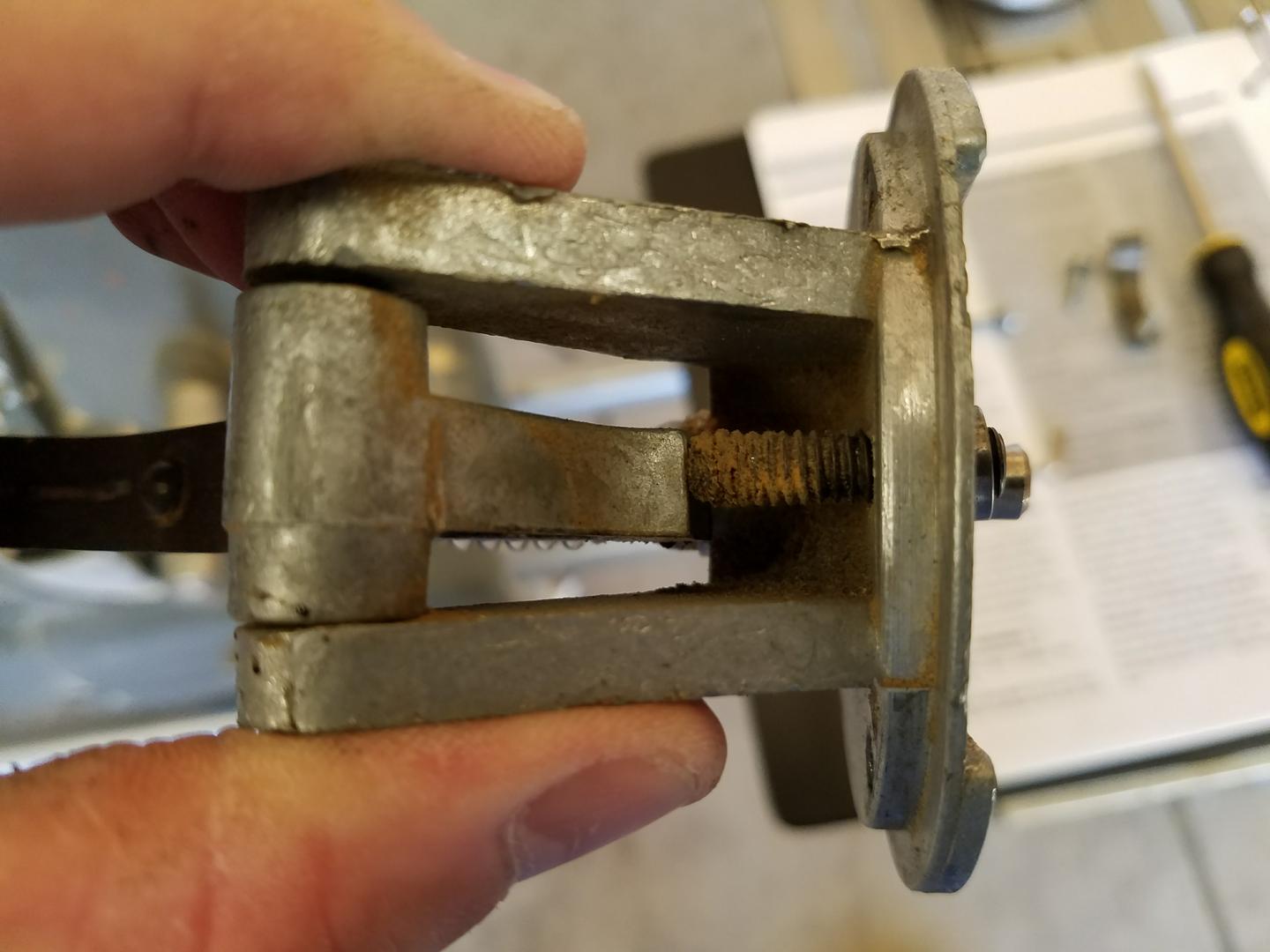

Take a look at your photo of the teeth on you pork chop (which mesh with the worm gear). There is uneven wear, especially at the top. It is caused by forcing the mechanism to slow speed too quickly and/or without adequate lube on the sheaves. It tends to bend the arms or ears that hold the pork chop apart, introducing slop, which then causes the pork chop to be off center to the worm gear, resulting in uneven wear. Made worse as the roll pin gouges away the soft metal of the pork chop. Yours isn't too bad. A light filing on the teeth can even that out.
There's also a permanent fix which involves replacing the roll pin that keeps the porkchop in with a bolt and some star washers and a nylon nut. Unfortunately, the member who pioneered that fix passed away not too long aog. He used to send a free repair kit to any member who mailed him. He posted his repair process somewhere on the forum, but I can't find it just now.

In this photo you can see how the arms have spread apart, and the pork chop is misaligned with the worm screw.
And this one shows how the worm screw tracks at an angle across the teeth.
When the repair is done the contact point of the worm screw will run down the center line of the pork chop teeth which is largely undeformed.

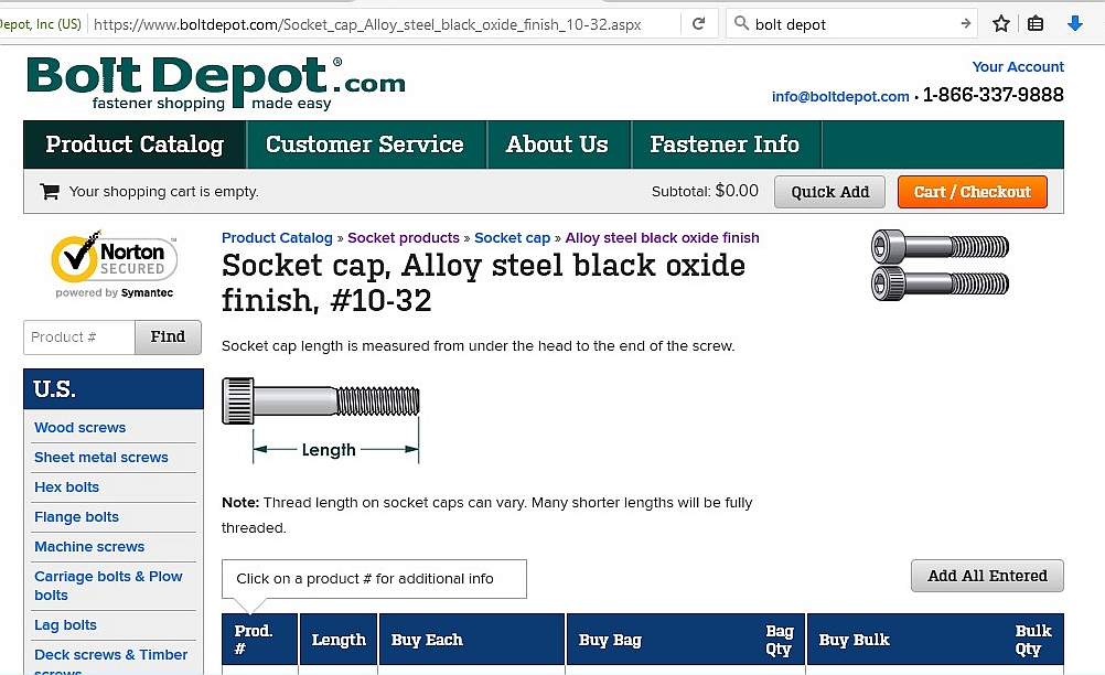

Excellent replies above. I would add that the screw Bill included was only threaded at the end so that the full od of the bolt was available(almost full width). That is much gooder than pivoting on threads.
A machine shop/supplier is more likely to have that type screw(long 3/16" cap screw).
You will never find it at big orange or big blue.

It would be best with a bolt that was long enough that the entire bore in the pork chop could rotate on the non threaded part. Less friction and wear.
Re: Speed Control Issues...
Greater 'bearing' surface. 'Peaks' of threads do not provide much surface area.
JPG wrote:Greater 'bearing' surface. 'Peaks' of threads do not provide much surface area.
In this particular application is the amount of bearing surface really all the important???
