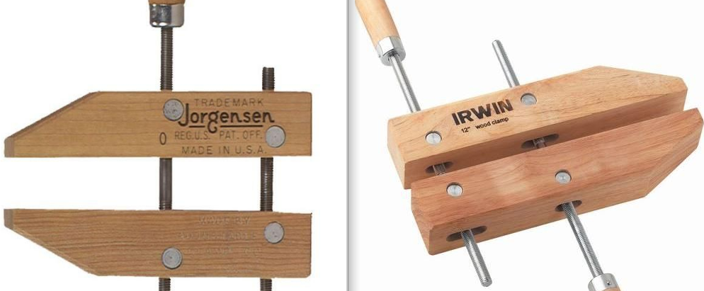

Pictures would help, but I have put down tape to protect other surface areas and used a small finger plane adjusted to layer it down, then used scrapers to finish it out.
I presume this is the clamp types you are working with
