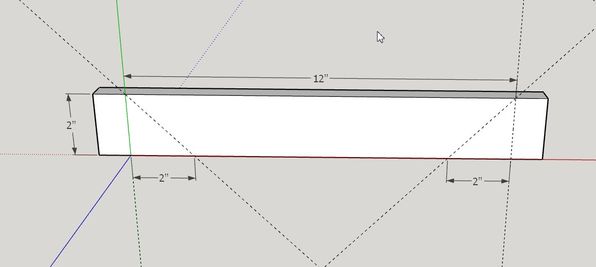

Hi, since you mentioned a possible mental block on the subject I thought this might be useful.
When cutting things that have 45 degree angles it helps to remember some basic geometry. A triangle that is formed in your case will have two sides of equal length, and for this case it will be the width of the material you are cutting.
So if you have say a 2" wide piece of stock and what to cut a frame that is 12" on the outside you can see it like this:
The dashed lines show up where you will want to make the cuts. Remember the waste side is to the outside here.

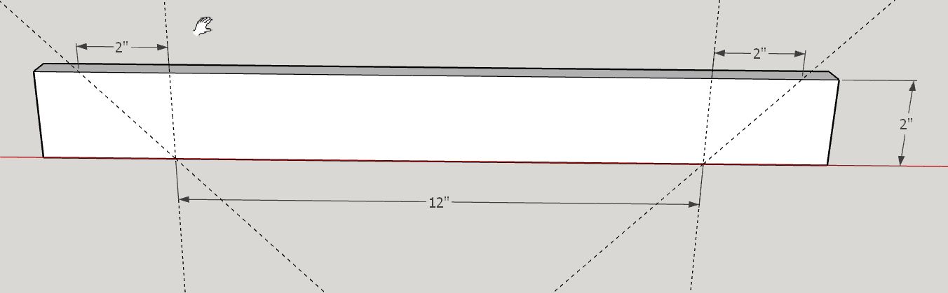

Like wise if you wanted a frame with a 12" inside it could look like this:
I'm not sure if this answers your questions but I hope it gets you back on the right track.

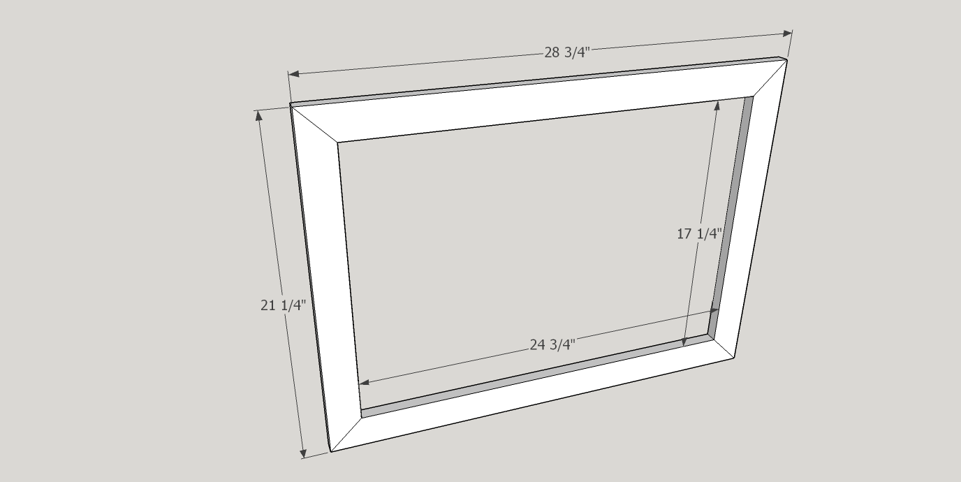

I read this thread and I believe that you are framing and opening (the air conditioner) that measures 24.75", 17.25". You did not define the measurements of the framing material but Ed prepared a diagram that shows the dimensions using 2" material.pilvr83 wrote:WOW! Thank you Thank you. I sure needed this.
I printed this all out.
Thanks again.
I did the same but created a slightly different drawing. Hope this helps more than confuse.
Remember, if you are using other than 2" framing material the outside perimeter measurements are wrong.

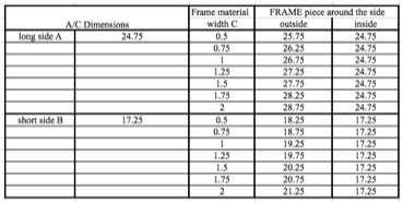

As Ed showed in his excellent picture, it is vital to visualize how the geometry works & make sure when you put wood in a miter saw (or SS) that you know which edge is the outside - so you don't cut the 45 deg the wrong way. if the object that you are framing around has long side A, short side B, and the width of your framing material is C, then:
Long side of frame: Outside is A + 2 times C. Inside length is A
Short side of frame: outside is B + 2 times C. Inside length is B
I attached a chart with various widths of framing material as an example.
In general I cut things slightly long & use the disc sander to sneak up on a good fit. Also, as was mentioned, a good suggestion is to cut a practice frame out of scrap. (make sure the scrap pieces are straight).
if your SS or miter saw is in good alignment, the corners will fit snugly. Other problems than alignment are not cleaning wood chips out of the way (a small chip on the fence or miter will really mess up the angles), wood that is not straight, flex of the framing material when it is being cut, etc.
- Frame Dimension Chart.jpg (29.4 KiB) Viewed 11737 times
