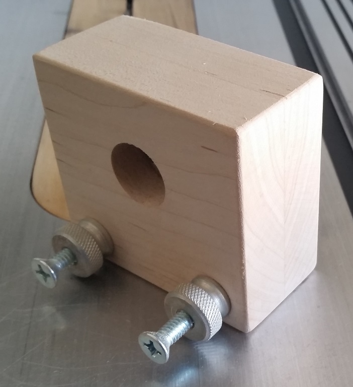

While using this (my home-made Cross-Cutter Jig):
Dado Jig.jpg (113.3 KiB) Viewed 5899 times

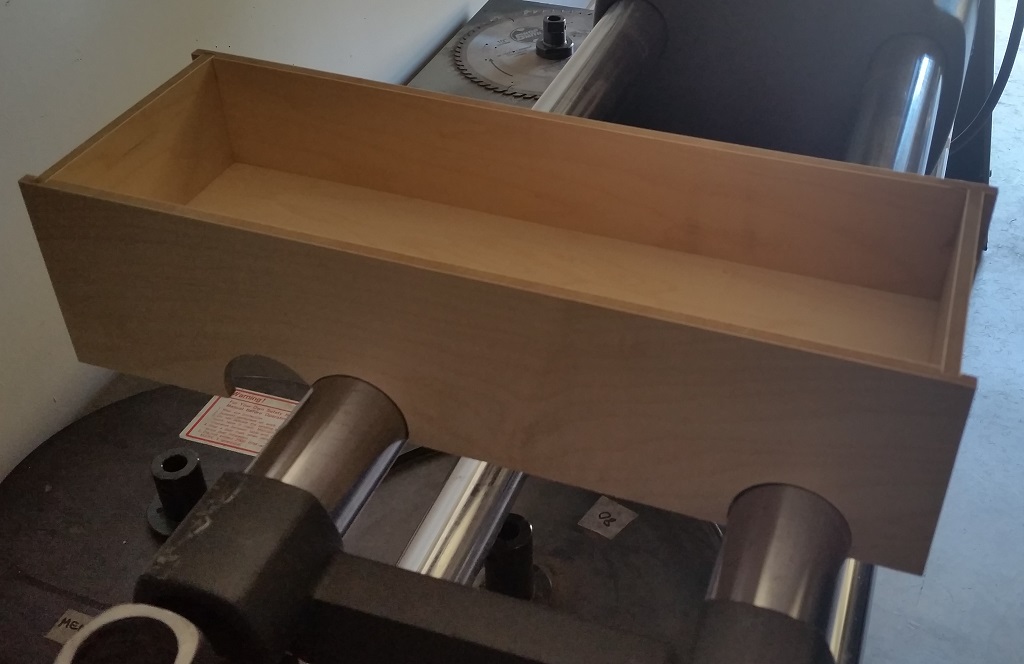

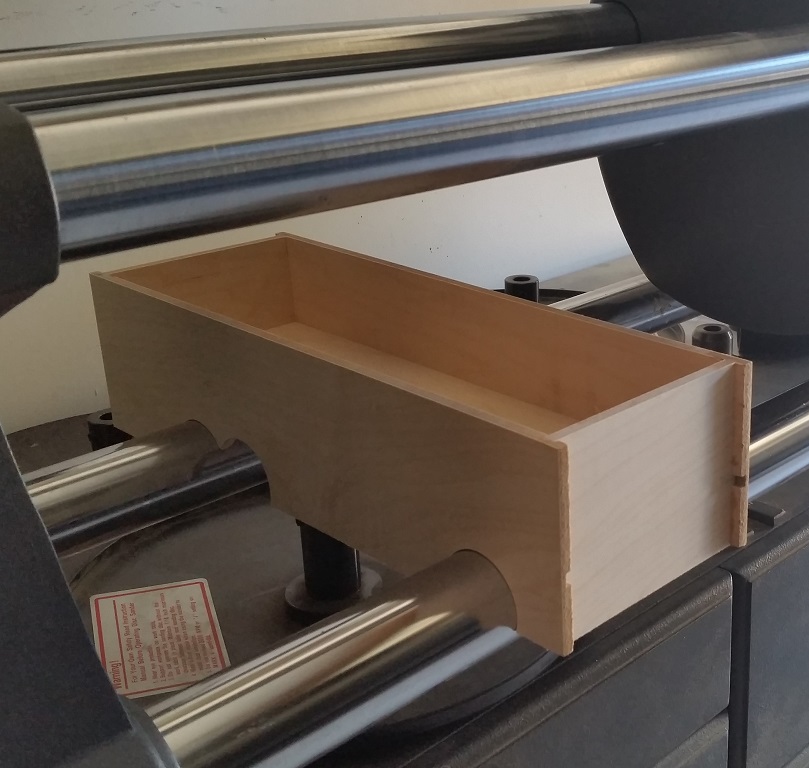

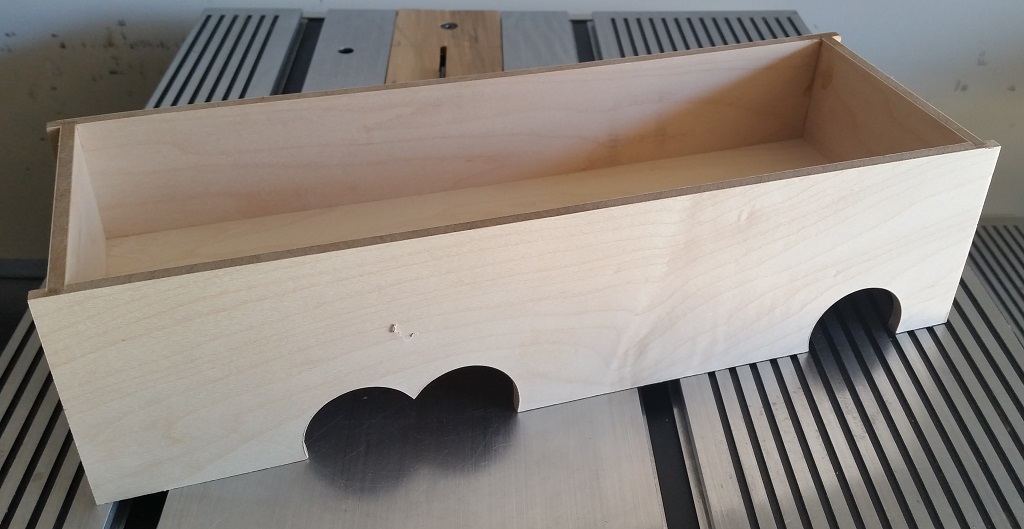

To make this:
To go here:
Tray Lower.jpg (158.77 KiB) Viewed 5899 times
Or to go here:
Tray Upper.jpg (143.72 KiB) Viewed 5899 times

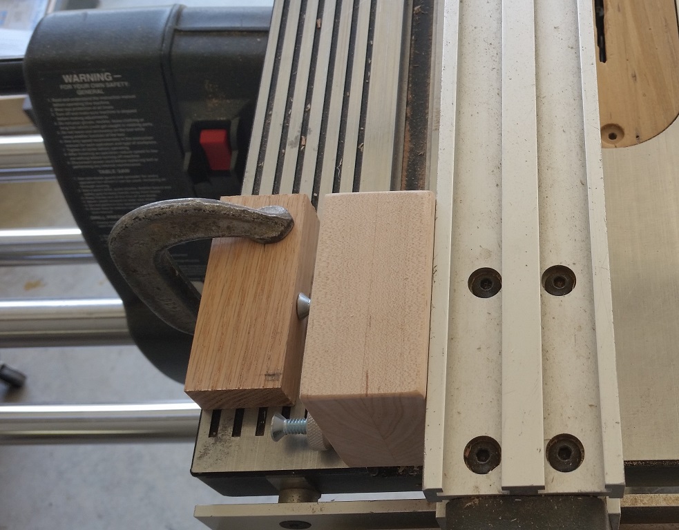

For the dados on the side pieces that accept the end pieces, I set up the Cross-Cutter jig and used it in the traditional manner. Then, to cut the dados for the bottom piece, I moved the jig to the other side of the fence, set the fence to make the first cut, then clamped a block of wood to the table so that it was just touching the longer screw. I then made the first pass cuts for the bottom.:
Dado Setting 1.jpg (213.01 KiB) Viewed 5899 times

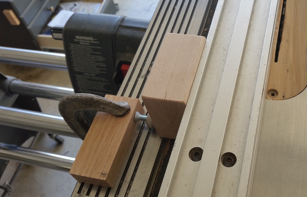

I then moved the jig on the fence so that the fence could then be slid to the point where the shorter screw just touched the clamped block. I then made all of the second pass cuts. It worked perfectly! Of course, this worked since all of my dados were the same width. I suppose this method could be used even if the dados for the bottom were to be different than the sides - it would just take another set of setup steps.:
Dado Setting 2.jpg (235.42 KiB) Viewed 5899 times
