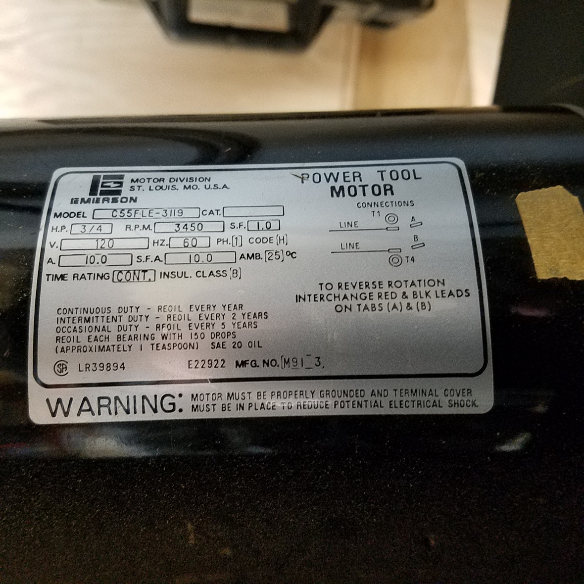

Re: Shopsmith Motor Project
I must have been dead wrong when I said I would have doubts regarding the usefulness of what this project creates.
I am not particularly interested in rewiring motors or even replacing bearings/bushings but understanding the configurations of the various applications is of interest.
For example: We frequently speak of some motors being reversible while others are not. While the motors in my Mark V are not reversible, the motors in my Crafters Station and Power Station are.
Some motors are sealed and require no periodic lubrication while others have oil cups and need to be serviced. The Crafters Station and Power Staion have motors that need to be oiled periodically.
I am also curious as to why Shopsmith (maybe Emerson) decided to bearing the one motor winding so deep that it cannot be extracted. If it could be, that motor would likely be reversible too. We'll probably not answer that question and I'll remain curious forever.
This forum has already taught me that some data (motor specifications) is available for research even though I was unable to find it via an online search. http://www.shopsmith.com/ss_forum/woodw ... ml#p240865
Two functionally equal motors of different vintage. My Crafters Station and Power Station. These motors have 5/8" shafts.
My Shopsmith Motors 015.jpg (1.23 MiB) Viewed 10268 times

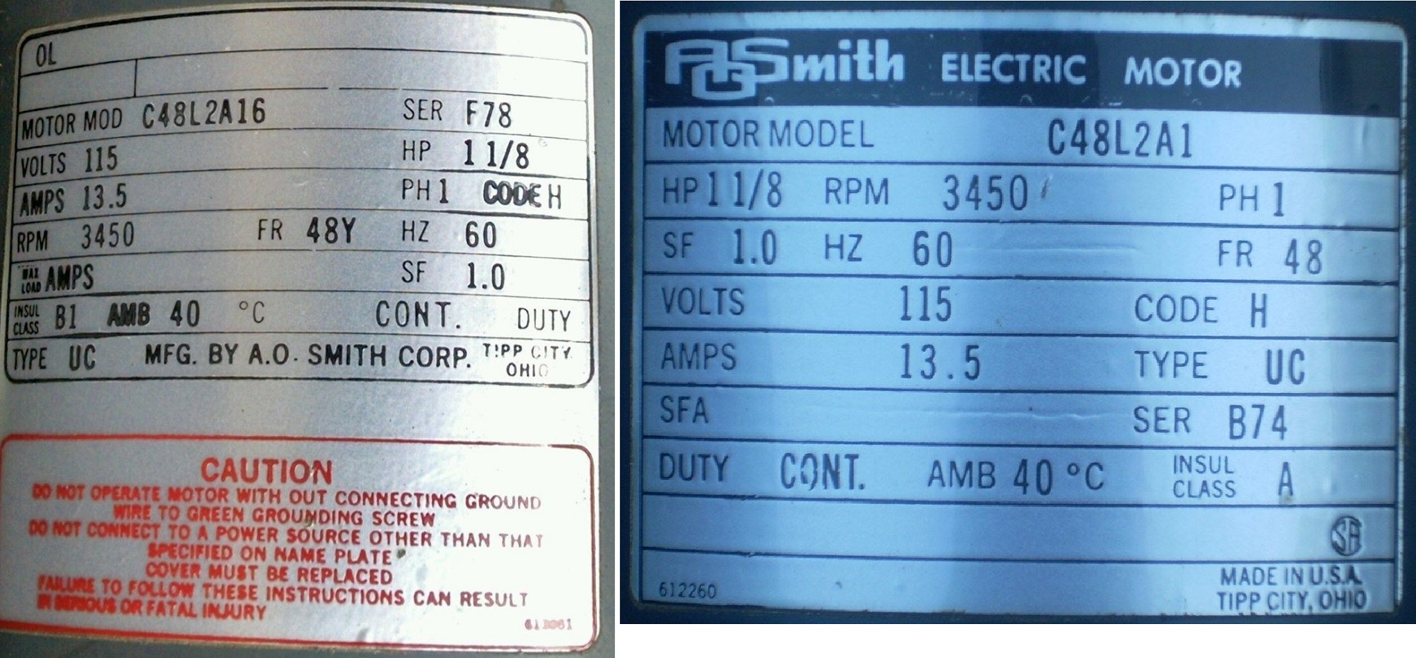

I have encountered two separate versions of a 1.125 HP (1 1/8 HP) A.O. Smith motors that are in different housings and have different labels.
I do not have disassembled photos of both motors to prove or disprove they are mechanically the same inside, have the same centrifugal switches etc.
I presume the C48L2A1 is the earliest version and the C48L2A16 is the latter. I am curious if there were a A11, A12, A13, or A14 versions released through the years.
I am trying to do due diligence to the Motor Guide I am working on and need to know what others have observed relative to this and other variants through the years. Not only on A.O. Smith but all the brands we know have been used.
Any information, especially photos of motor tags would be helpful.
See attached.
I so miss my late friend Bill Mayo. He would have so much to contribute.
Everett
Two Versions of Shopsmith 1.125HP AO Smith Motors.jpg (527.08 KiB) Viewed 9988 times
