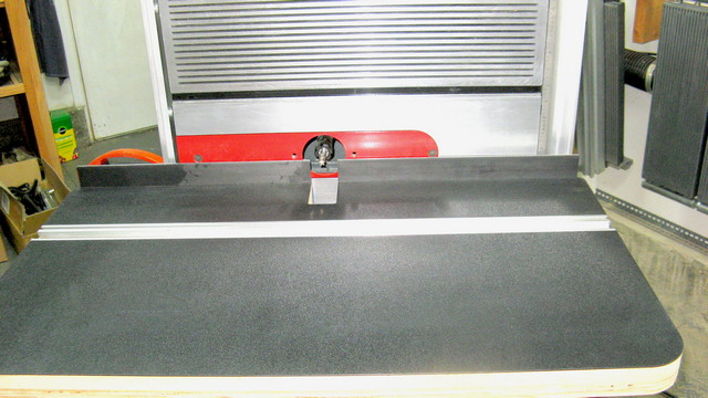

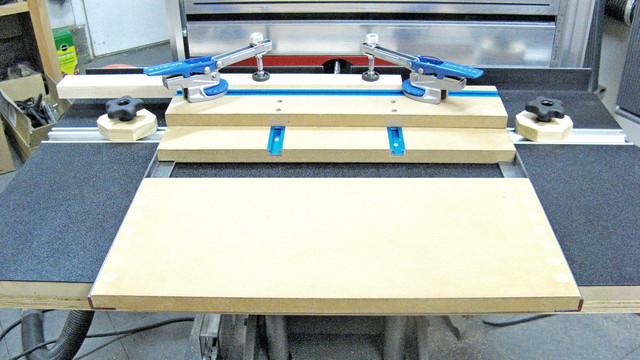

I don't want to hijack your thread but I think this is very related. After I upgraded to double tilt earlier this year I built a horizontal router table that uses an extension table base. I turn the main table around like you would for under the table routing and set it at 90 degrees. Here are some pics.
- IMG_0764.JPGn.JPG (65.92 KiB) Viewed 24288 times
- IMG_0756.JPGn.JPG (85.82 KiB) Viewed 24288 times
Re: horizontal mortising
I was asking if the mortise can be made with the head stock in the normal position. I have used this set up to drill a mortise and the clean it up with a chisel, but thought about using a router bit and sliding the stock along the fence. Then I thought I might be able to do the same thing with the tenon, using the table and depth stops. I think you have given me the information I need. My question was really prompted by a shop built slot mortiser that can cut tenons on the end of a longer piece of stock. Thanks, sometimes I get to involved in finding a $20 solution to a $.02 problem.
