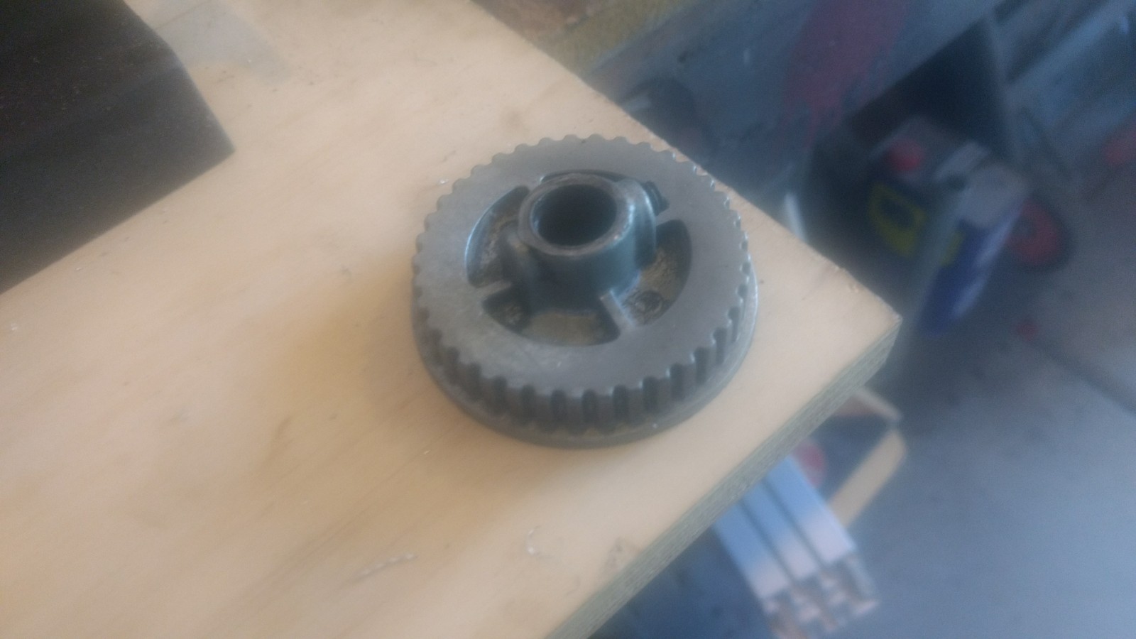

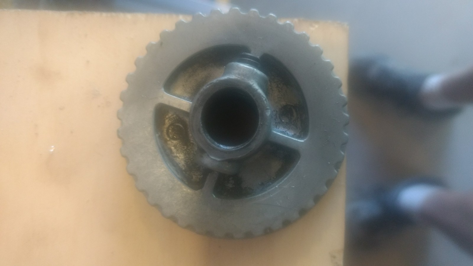

- Original pulley
- IMG_20171108_151615768.jpg (150.57 KiB) Viewed 22895 times
- Pulley showing ovalled hole
- IMG_20171108_151623775.jpg (154.96 KiB) Viewed 22895 times

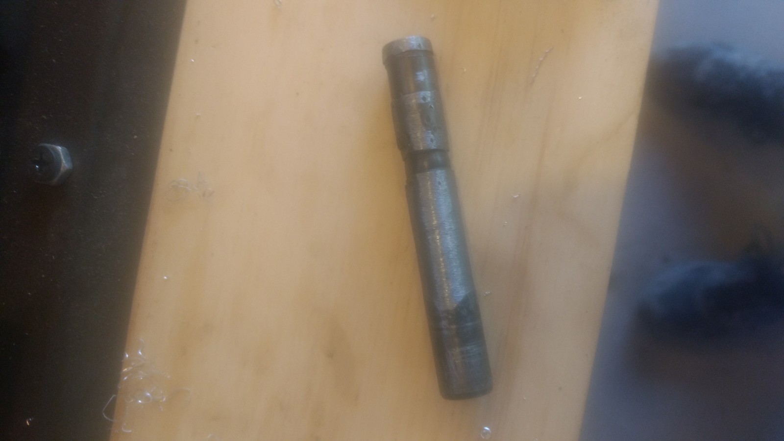

- Original shaft
- IMG_20171108_151637841.jpg (139.93 KiB) Viewed 22895 times

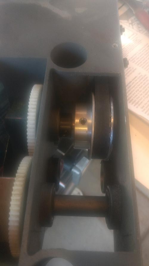

trying to add photos again!
- the pulley, shaft and collet in place
- IMG_20171108_151646846.jpg (40.4 KiB) Viewed 22862 times

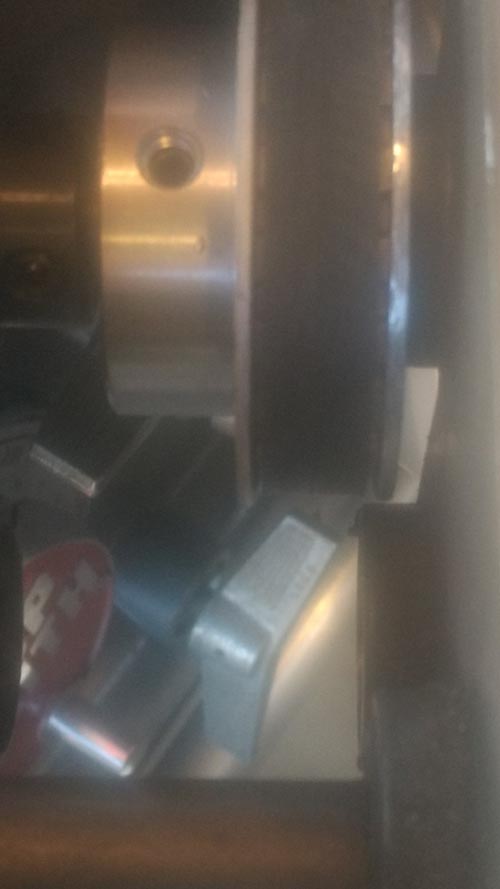

Re: Motorized scroll saw repair
closeup of pulley
- closeup of pulley
- IMG_20171108_151716171.jpg (46.13 KiB) Viewed 22862 times
