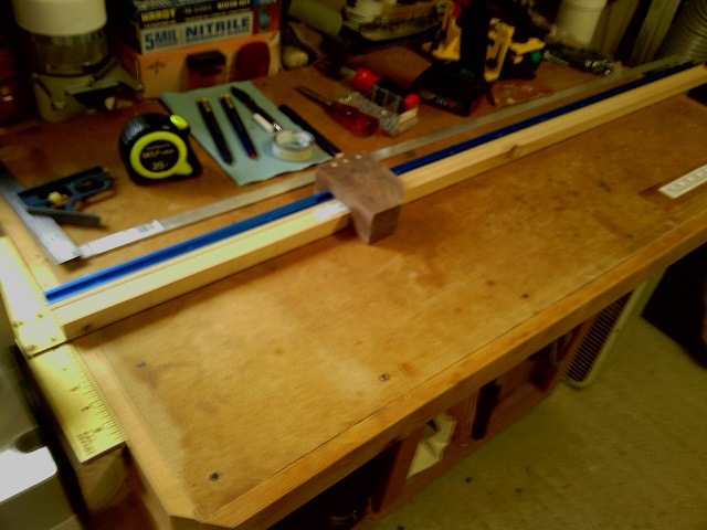

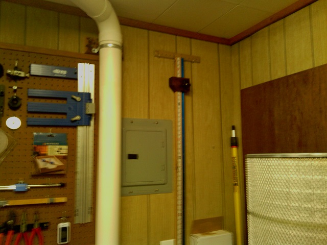

Yep my thought exactly about the thin kerf thing, not to mention as I think about it, that thin kerf is gonna throw my temp stop block rail (that's what I call it) I made off by the difference between a full kerf and a thin. I custom made it for my csms and registers off my bench to the right of the csms, no way to adjust it unless I shim it...lol...so I guess a full kerf is in order, so it's between Tenyu and Forrest I guess, I am leaning real hard towards the Tenyu, thank you Gene for suggesting it. If I had gotten the Freud and made a bad cut with my stop block rail (because the tape measure would be off), I sure would have been mad...lol...that's the problem with custom jigs and fixture they are so dependent on blade widths.
In case anyone is interested, stop block rail
In process of making in position against bench right side of csms.  made with old dry wall square tee portion cut down and tee track installed with stop block (walnut)

Only pic I had completed hanging on the wall
SBR 2.jpg (89.08 KiB) Viewed 9176 times

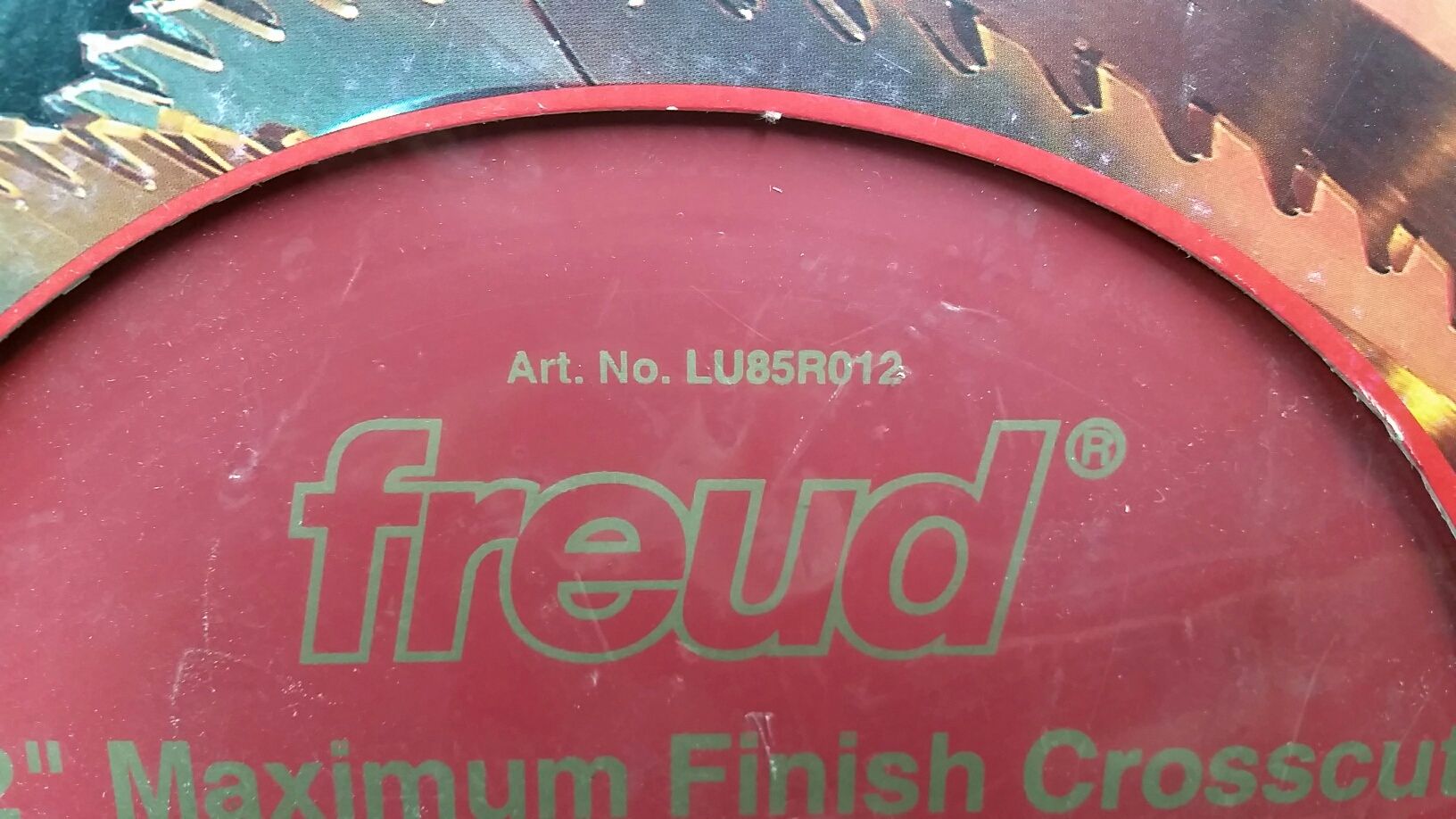

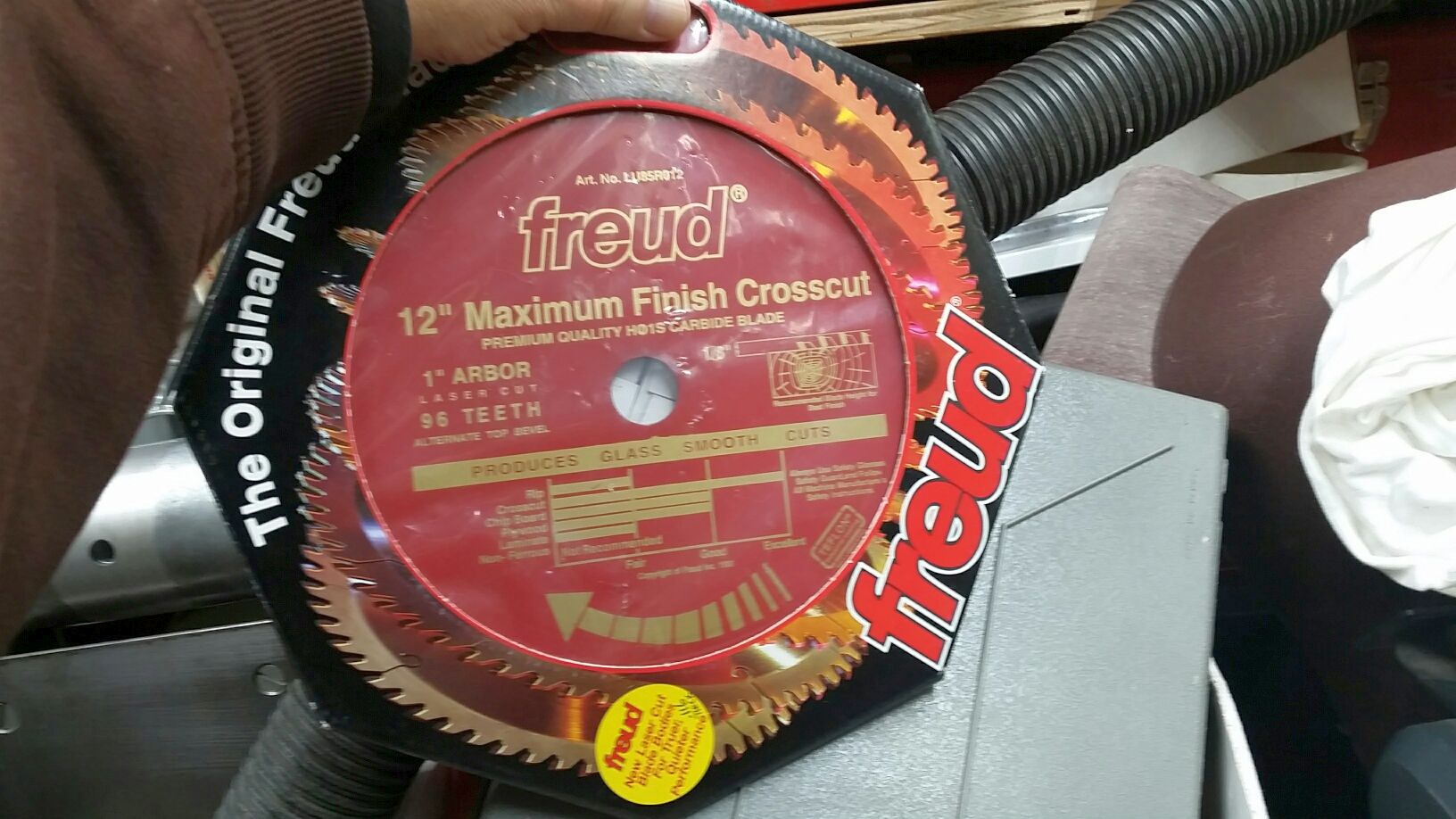

I have a plain 12" miter saw and went with the Freud LU85R012 which is a 96 tooth blade made for such saws. It gives the finest cuts you can imagine. It also costs in the $125 range.
Typically you need to shop for miter saw blades NOT table saw blades. You are looking for a blade that excels in cross cuts. You also have to match the arbor hole, on mine that is 1". The blade is not a rip blade, the blade is not thin kerf but thinner then some. From my notes I measured it at .116" which makes it thinner then .125" blades but thicker then .097" blades. Most miter saw blades are in this range so if you are worried about calibration you better check what you have now.
Again the critical things are arbor size and making sure the blade is made for a miter saw.
If I ever have to replace the blade I'd look at this one:
https://www.infinitytools.com/saw-blade ... t-110-kerf
I've been really happy with Infinity blades and that is pretty much all I buy now.
BTW I've had really good experiences with Freud blades including thin kerf for the shopsmith and rip-line blades. They use to be my go to blades and I still get some for my circular saws.
I keep the stock blade on the 12" saw for most work and then put the finishing blade on when I want/need fine cuts. And so you know that this is how it is here are the pictures:
BTW Amazon sells these blades but the image is not for this blade???
https://www.amazon.com/Freud-Tooth-Cros ... +saw+blade
I got this blade back in early 2001 so it is not something new or different anymore.
