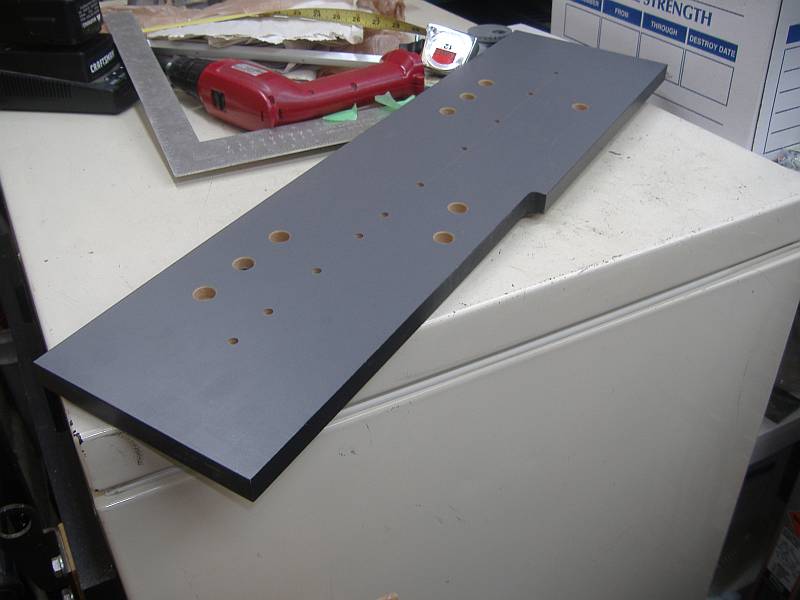

Anyone have a PDF of the shopsmith 555653 fence? I'd like to build one for my jointer, and need the specifics.
Thanks!
Troy

- DSCF2030sc.jpg (56.44 KiB) Viewed 16689 times

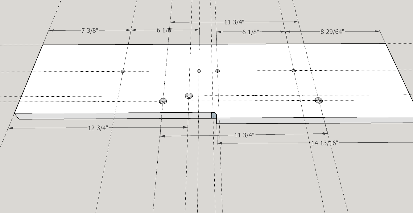

Sorry! I can't help with a PDF but even if I could what I have is unlike what you show in this image. The holes in mine are completely different (just different vintage, I am sure).AKTroy wrote:Anyone have a PDF of the shopsmith 555653 fence? I'd like to build one for my jointer, and need the specifics.
Thanks!
Troy
But since you are making your own I would suggest that you just make it to meet your own personal needs. Why copy the Shopsmith design?
However, if this will help I have attached a sketch of mine:
The thru holes (7) are all 5/16". The counter bores (3) are 9/16" and are bored 3/8" deep.
The small holes (4) have threaded inserts.
In your image, the row of small holes are presumably for feather boards. As for the upper row of counter bores holes, I have no idea.
The upper counter bore in my sketch has never been used. I don't know what it is for.

Thank you. Just what I was after! I was not sure what the top holes were for either, but I think for the table saw fence. Maybe you flip it?dusty wrote:Sorry! I can't help with a PDF but even if I could what I have is unlike what you show in this image. The holes in mine are completely different (just different vintage, I am sure).AKTroy wrote:Anyone have a PDF of the shopsmith 555653 fence? I'd like to build one for my jointer, and need the specifics.
Troy

They would be for the featherboards.AKTroy wrote:Thank you. Just what I was after! I was not sure what the top holes were for either, but I think for the table saw fence. Maybe you flip it?
Troy
see the picture in the link. http://www.shopsmith.com/ownersite/cata ... ncekit.htm

I think I disagree. The feather boards mount in the holes with threaded inserts (the center roll of holes). The holes in the upper row are all counter bored (bolt comes out the back side.rpd wrote:They would be for the featherboards.AKTroy wrote:Thank you. Just what I was after! I was not sure what the top holes were for either, but I think for the table saw fence. Maybe you flip it?

Right you are.dusty wrote:I think I disagree. The feather boards mount in the holes with threaded inserts (the center roll of holes). The holes in the upper row are all counter bored (bolt comes out the back side.
HELP! Somebody with a newer fence extension than mine.
According to Nick, (1:53 in the video) the axillary fence was sold for use on both the jointer and table saw fences, One presumes when used on the table saw fence the flat side would go to the bottom, and those holes would be used to attach to the fence.
In the video he uses them to attach an out feed table to the jointer.
[youtube]https://www.youtube.com/watch?v=ZxAd-t2VBV0[/youtube]

I have to say that picture looks mighty familiar. Maybe because it was taken in my garage?
Did we get all the questions answered or do I need to dig out my paper work?

I think so, except for the holes etc. thee added and for what purpose.reible wrote:I have to say that picture looks mighty familiar. Maybe because it was taken in my garage?
I think verification of 'guesses' above would be 'nice'.
