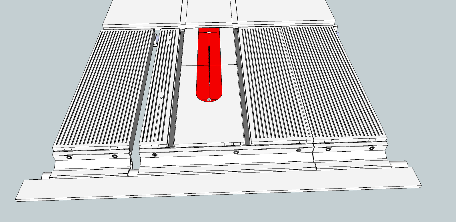

Steve, this can be done and with great precision. I do it frequently and on either side of the main table though I prefer ripping on the right side.
It can even be done with the rip fence mounted on the floating table and the floating table moved to achieve the width of cut that you need. However, doing this gets to be a crap shot as you get further and further away from the main table.
Main Table and Two Floating Tables for Rip Cuts.png (71.62 KiB) Viewed 10476 times
I have it shown here on a 520 with the Pro Fence but it works the same on a 510.
What needs to be done as preparation is make certain that the front rails are in line with one another. The rip fence is referenced off of the "front rail".

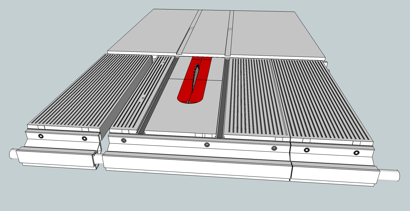

If you have tried this already and you still have an issue, check your extension tubes to make sure they are straight and use a precision straight edge to check the front rail alignment. Make certain that the extension tubes are secure in the rails (no tools required...finger tight is sufficient).
Main Table and to Floating Table Alignment.png (90.93 KiB) Viewed 10473 times

And 3. Most important, I did not use any extension tubes, and as I can see a BIG mistake on my part. I was attempting to set it up with just the auxiliary table with the posts. I now can see, THANKS Dusty, using the extension tubes stabilizes and aligns everything. My front rails are aligned which is why I was stumped.

The tubes may 'pull' the rails into alignment, but that implies they were not aligned without them.
I would secure the tables with the tubes and then loosen he nuts securing the aux table to the mounting posts(all 4 at once), then retighten the nuts very carefully and sequentially a little at a time so as to not bias the table from the 'aligned' position.
Hopefully that will eliminate(or at least minimize) the mis-alignment.

I agree except that I would loosen the four table bolts on the extension table (let it float), install the extension tubes, tighten them to the rails and then re-tighten the four extension table bolts. Remember that the most important element here is the reference surface (front rails) which must perform as one and be perpendicular to the the plane of the blade.
