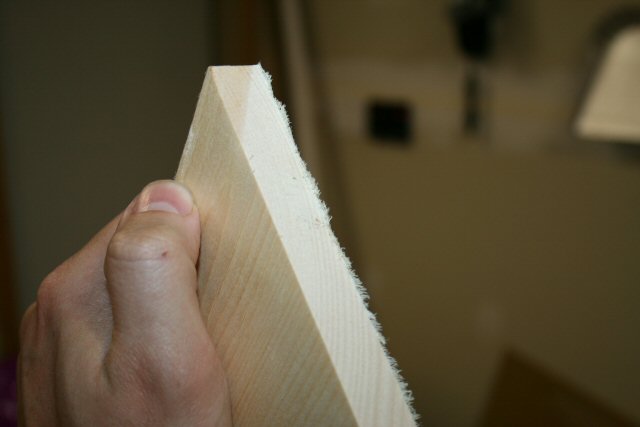

One thing I noticed was that the acute angle side being drawn against the saw blade rotation developed some fuzzies:
[ATTACH]1798[/ATTACH]
This only happened for the specific combination of acute angle being pulled against the blade. It did not happen on the very same pieces when they were cut straight across. I have a Freud blade which is supposed to be good, but maybe this is normal.

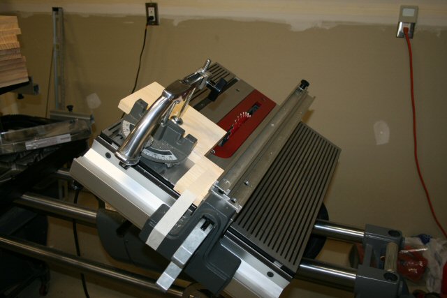

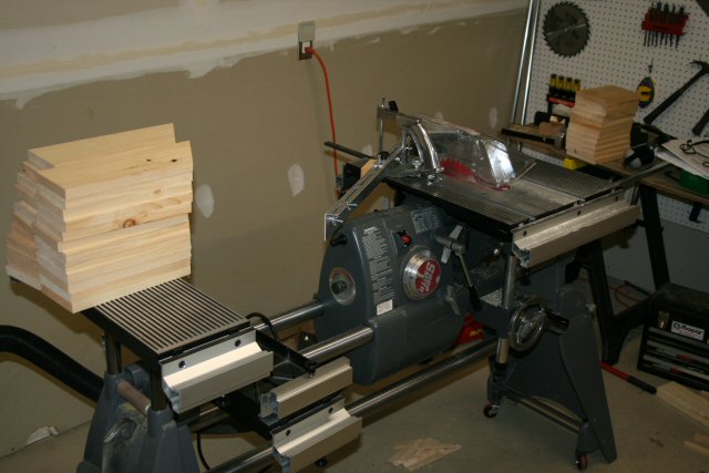

The next step was to put 30 degree bevels in both ends of the roof panels and one end of the front panel. This was accomplished by tilting the table:
[ATTACH]1799[/ATTACH]

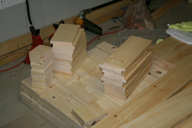

All the panels were originally cut from stock with a flat table, and the panels which needed bevel cuts were cut slightly oversize to allow the bevel cut with the tilted table. You can see how I cut them above. I used masking tape and taped a stop block to the rip fence. This prevented the stop block from getting pulled toward the blade as I advanced the miter gauge. The stop block automatically moved up and down the table as I adjusted the rip fence to cut a precise bevel from the flat end of a piece of stock.
I think a normal table saw would have been easier. Since the blade tilts and not the table, I could have loaded up the full 8' length of a piece of stock and just made repeated slant cuts to the precise length of the needed panels, instead of having to straight-cut the panels then bevel them afterwards.

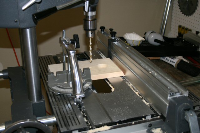

Next we converted the Shopsmith to drill press mode to cut the entry holes and perch holes:
[ATTACH]1800[/ATTACH]
Using the bimetal hole saws was a bit scary because I was not sure what speed to run them against (it was not specified anywhere in the Milwaukee hole saw manual) and they made some interesting noises when first engaging with the wood surface. We had to clean up impacted sawdust from the hole saw teeth often. A good spade bit would probably have been easier. We cut holes at 1.5", 1.75" and 2" in diameter.
The Shopsmith in drill press mode made this operation trivially easy. We moved the rip fence to the desired vertical position of the hole, and used the flip-down stop to always keep the bit centered horizontally centered on the front panels.

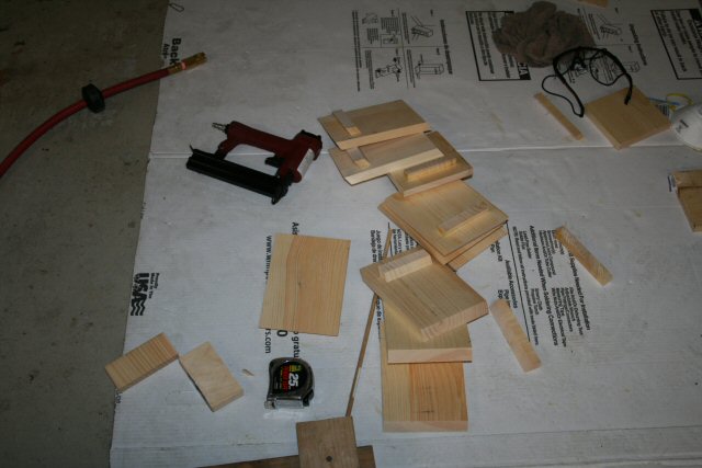

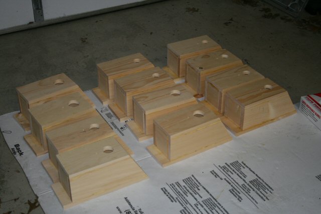

Once all the panels were cut, we began assembly. We used Titebond II interior/exterior wood glue and a Harbor Freight brad nailer with 1" brads. Jim spread glue on the joints, and I nailed them up. This was pretty easy with a pneumatic nailing tool; we could not fathom how much more difficult this would have been trying to hand-nail panels together with the glue joints slip-sliding around. We got a pretty good rhythm going about halfway through.
Here's a picture of the assembled birdhouses:
[ATTACH]1801[/ATTACH]

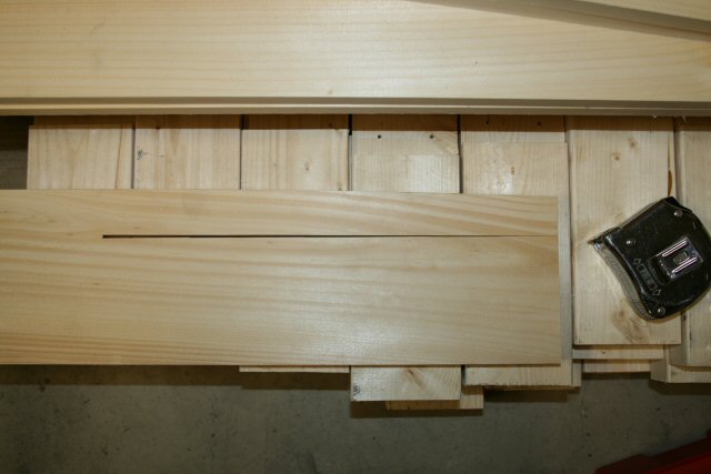

[ATTACH]1804[/ATTACH]
but the splitter was in place and it should not have been binding the blade so severely. I clearly don't have something set up properly.

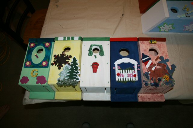

While we were getting the roof panels finished up Sunday morning, Tricia and Kendall were hard at work decorating the houses themselves. Here are some pictures of the finished results:
[ATTACH]1806[/ATTACH]

Now if I could - I would like to throw in a couple of critiques of the woodworking. I do this only because I know you are just beginning on what will be a lasting hobby.
Let me comment on the pinching (while ripping) you observed. You didn't do anything wrong here except choose the wrong board (or the wrong edge of a board) to rip. If you look at the 'pinching'/ saw kerf-closing photo, you can see you have a plain sawn board. (Nothing to cause concern yet) - - You can also see that this board was sawn from the log in a manner that was not parallel to the grain of that log. The way that happens is: if there was a crook or bend or severe taper in that log - the side of the log resting on the sawmill carriage presents the top of the log at an angle to the sawmills blade. (the sides of the log are also similarly affected)
At any rate, when the slabs are removed you get a cant of wood where the grain runs does not parallel with the sawmill carriage. The resulting boards will have grain that runs in a slant to the edges of the board. This is what you have/had. When you find that situation, the chances are greater that the board will contain wood under stress, or reaction wood. Some reaction wood is non avoidable. Your board looks to have a goodly amount. Although there is no way for most of us to avoid reaction wood, it (if possible) behooves us to inspect the boards before buying to look for signs of it. Diagonally grain is one sign.
Personally, I prefer rift sawn or quarter sawn straight grained. Sometimes out of wider boards, you can rip narrower boards that have better grain configuration and if necessary edge glue them back together. - -

Next - I would like to throw in a minor critique of the positioning of your miter gauge when sawing the slanted sides of the houses. I wish you photo had included a floating table on the left side of the blade to support the miter extension. This would have made your cuts perhaps a bit less fuzzy on the bottom. Personally, I like to use the other side of the blade for making such cuts. The wider table on the right side gives more base without adding floating tables. (I use the same aluminum extension)
Speaking of the right side and left side of the blade - Although you properly used a spacer so our cross bevel cut did not ride on the fence, you really should have used the other side of the blade and kept your workpiece under the blade and the cutoff to the upper side. Reference: PTWFE Pg. 33. This is a safety issue. If the workpiece slips, it will not fall into the spinning blade as easily, and you can remove the workpiece from below the blade, rather than above it.
