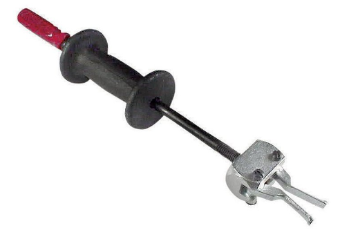

Blind Internal Bearing Pullers come in a variety of configurations.
K Tool International Pilot Bearing Slide Hammer Model # KTI70356 spreads from 1/2" to 1 1/2" and sells in the $30-$40 range.
SKF and other bearing suppliers offer various versions as well that are more expensive.
Everett
