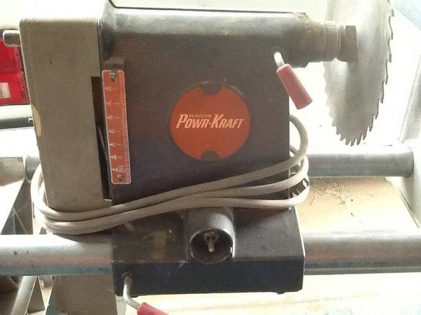

I know that the common perception is that Only Montgomery Wards sold the Mark 2, but I found a May 1958 Popular Mechanics Ad that suggests Magna sold the Mark 2 as well as Wards. That's at least what the Ad says.
I know there is a different PowrKraft branded one, that I believe was even more cheaply made. I will dig up a picture of one of those too.
Everett
