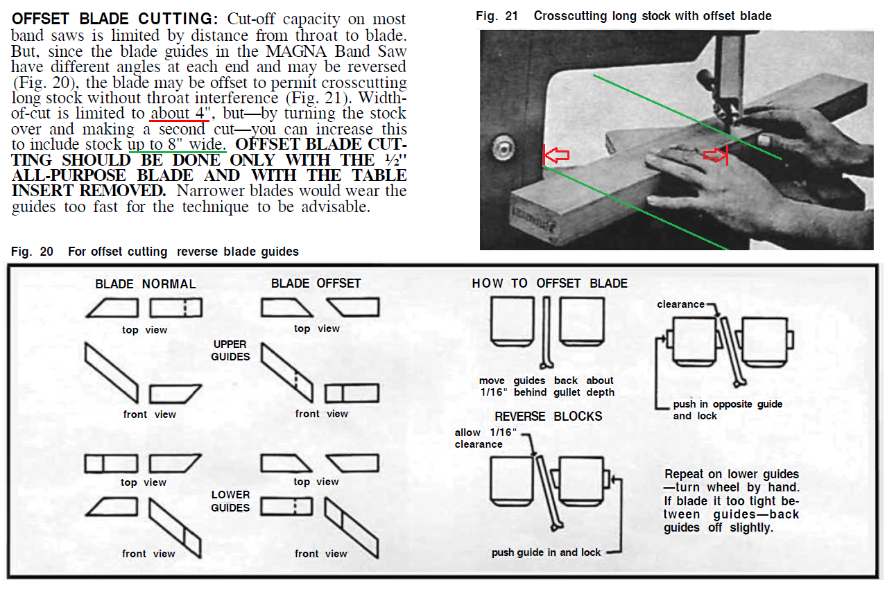

Sort of in that vein, but for others who are not as familiar with the Bandsaw features as you, I have been asked why the blade guides have the odd angles on them opposed to being flat. That too was first documented in the original Bandsaw manuals.
As part of a work-up I was once working on for a Bandsaw documentation piece that I may later decide to actually write, I extrapolated a photo and text of that, adding some color to illustrate what they were designed to achieve.
Blessings,
Everett
Bandsaw Angled Guides allow wider throat for cutting.png (586.01 KiB) Viewed 6536 times
