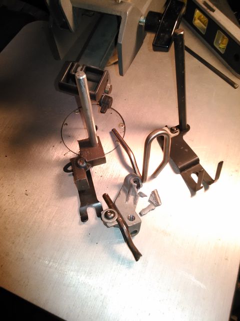

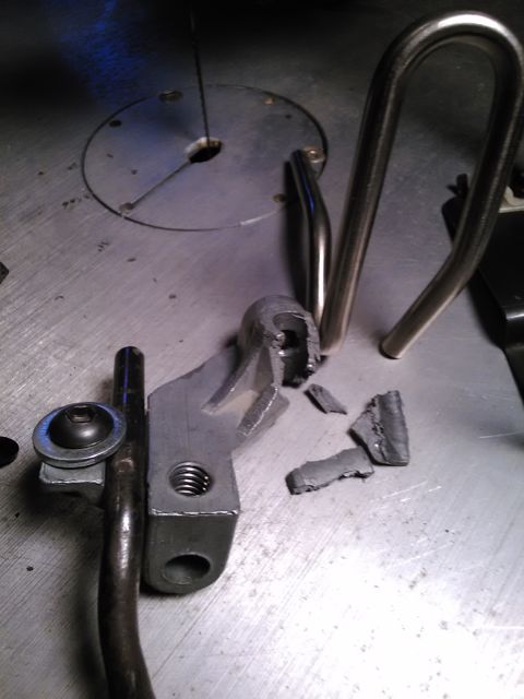

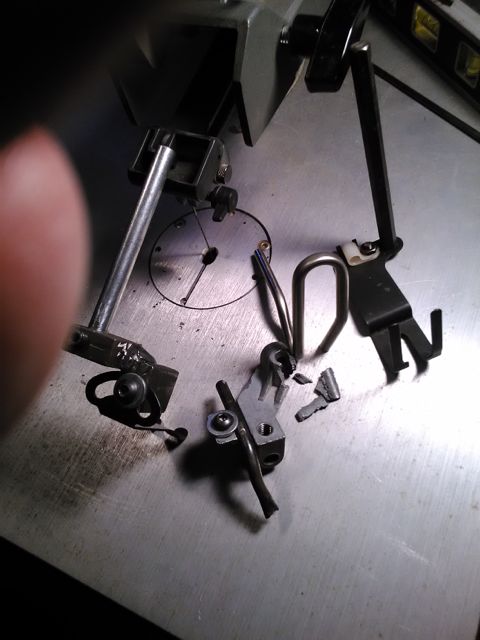

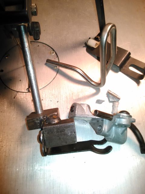

Found the foot casting on my grey scroll saw broken and full of cracks. Took some measurements. Hand cut two half inch thick steel pieces. Welded them together at 90 degrees to each other. Drilled and tapped as needed. Still needs some finishing touches.
