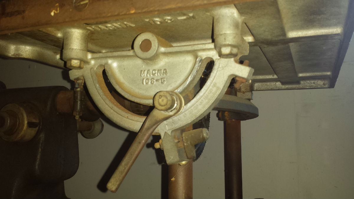

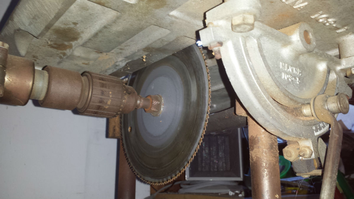

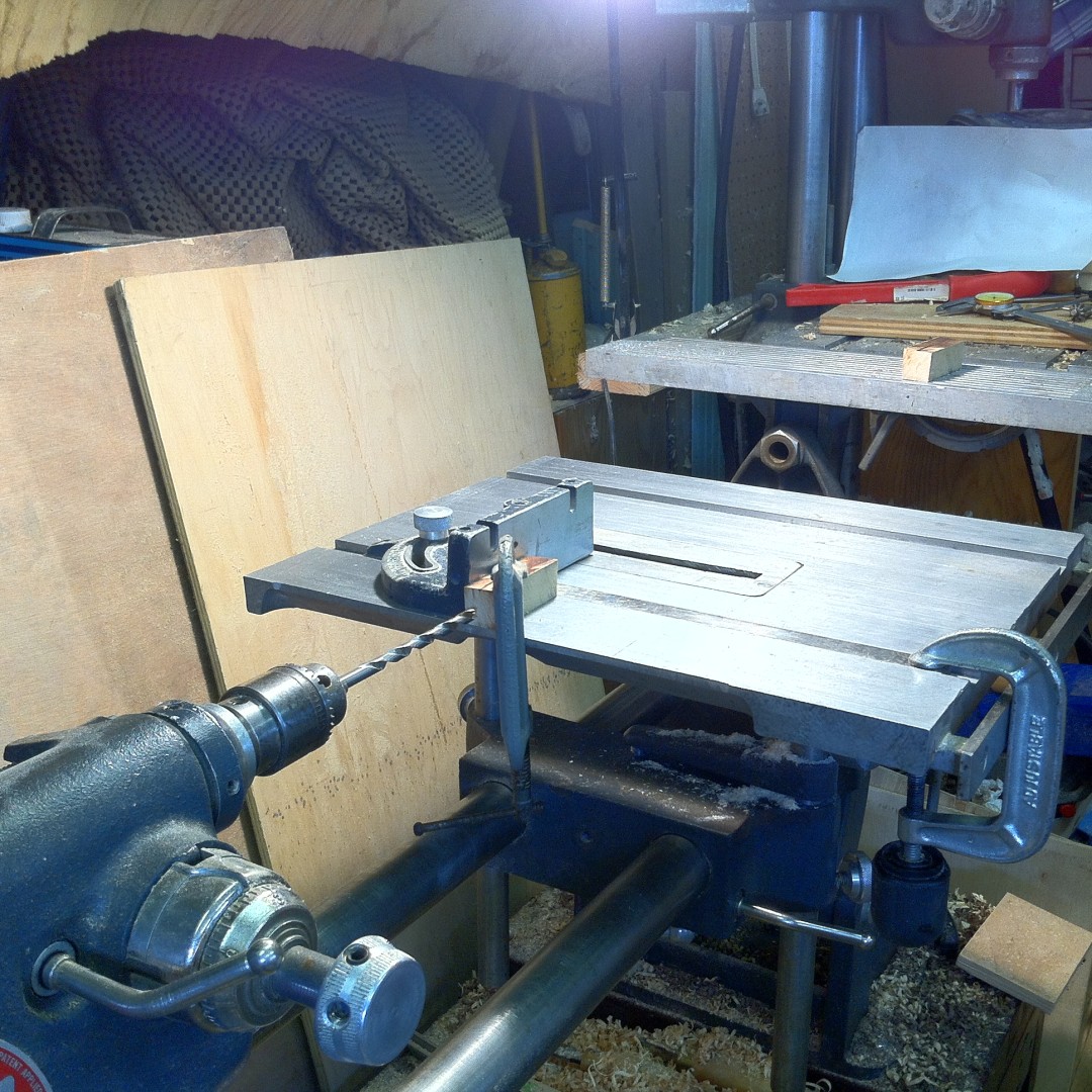

Hi, My dad has an old Shopsmith Model 10E that I am trying to get up to snuff and it has a table saw that turns at a very slow crawl that I'd like to fix. I don't know if the parts are old or if I need to adjust something.

You might want to pend some time here reading up on how the model 10's work before jumping into operating it. What I can see 1st is that that machine has a speed increaser/decrease so it might just be set for a slow speed. More concerning is that the saw blade is attached using an improper mandrel designed for a drill chuck. Not recomended to operate like that safely.

Ok. first the saw blade should be mounted on an arbor, not in the drill chuck.otabe wrote:Hi, My dad has an old Shopsmith Model 10E that I am trying to get up to snuff and it has a table saw that turns at a very slow crawl that I'd like to fix. I don't know if the parts are old or if I need to adjust something.

In the third picture the tie bar (spectacle looking piece, under the power cord) should be at the left end of the way tubes.
Also there is something odd happening with the quill lock, i can see the end of a bolt in the hole, but there should be another lever similar to the headstock lock there.
in this picture it is left of the quill advance and right of the nameplate. (The picture is of a 10er so there will be minor differences.)
