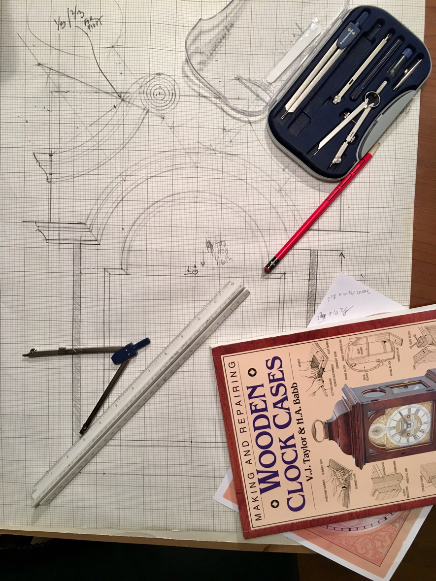

Well, I posted about this project before and I never even got started because life got in the way. What you are looking at in this first picture is my first rough attempt to draw the hood of a grandmother clock I am going to try to build, most likely very slowly, given my various time commitments.

I should add that I also have a "set" of measured drawings of the original, antique clock, which were in a book that came from my Grandfather's library. The plans are very basic. A front elevation, a side elevation, and details on the molding profiles. Mostly it's just outside dimensions and a few details of how the original was built. I've already had to depart from them to draw the hood door and its wider, taller arch, which of course changes the geometry of the rest of the hood.
To give you an idea about how far this is outside of my comfort zone, it was a challenge just trying to figure out how to draw the curve of the swan's neck molding. It isn't a typical symmetrical, Roman ogee; and while the measured drawing shows the shape, it gives none of the details to reproduce it in terms of the arcs that make it up.

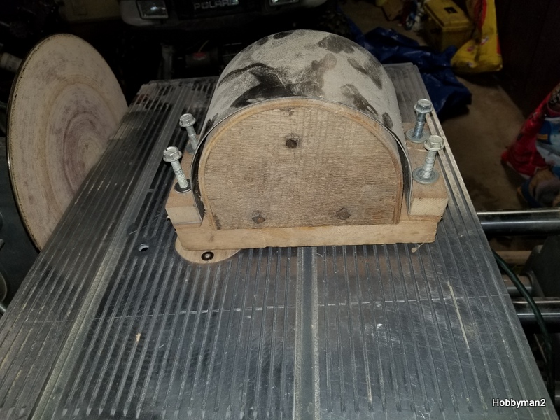

I have a jig used to steam bend the curve for th top if you would like I can take a picture of it with rough layout and you an make one to fit your project, the jig I have is used fro mantel clocks.

Hobbyman- I would like to see that! I have thought about 2-3 different ways to do it and steam bending wasn’t one, so I’ll definitely want to have a look.

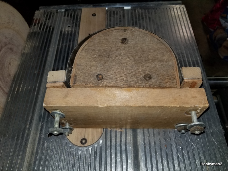

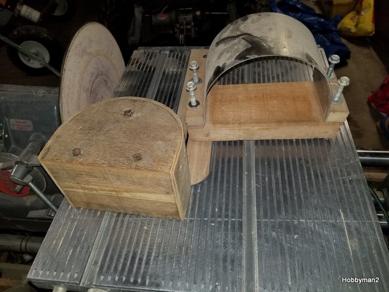

So I have never used this , I was supposed to aquire the entire set the fella has but it never came about, this is a clampiing jig used mny times by a clock maker , he would soak his pieces over night , most of his bending was done using 3/8 or thinner material. he would re saw his stock from solid wood, mostly cherry / walnut , if you dont have a source on the metal I cant see why the top couldnt be made from wood .
drying time varies on several things . I was planning on making a couple clocks using his technique, the fella past away a few years ago, his work was some of the best I have ever seen.
You can customize the jig to any configuration ,, he had several styles .
