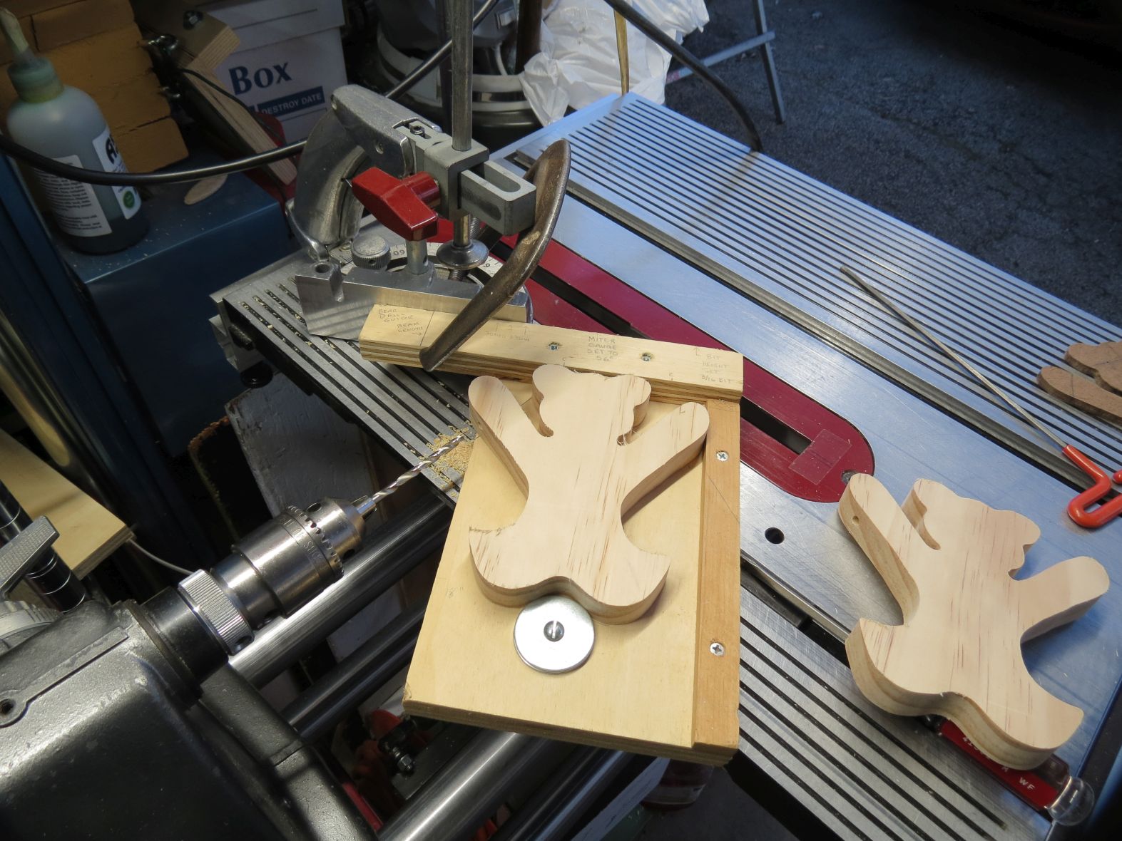

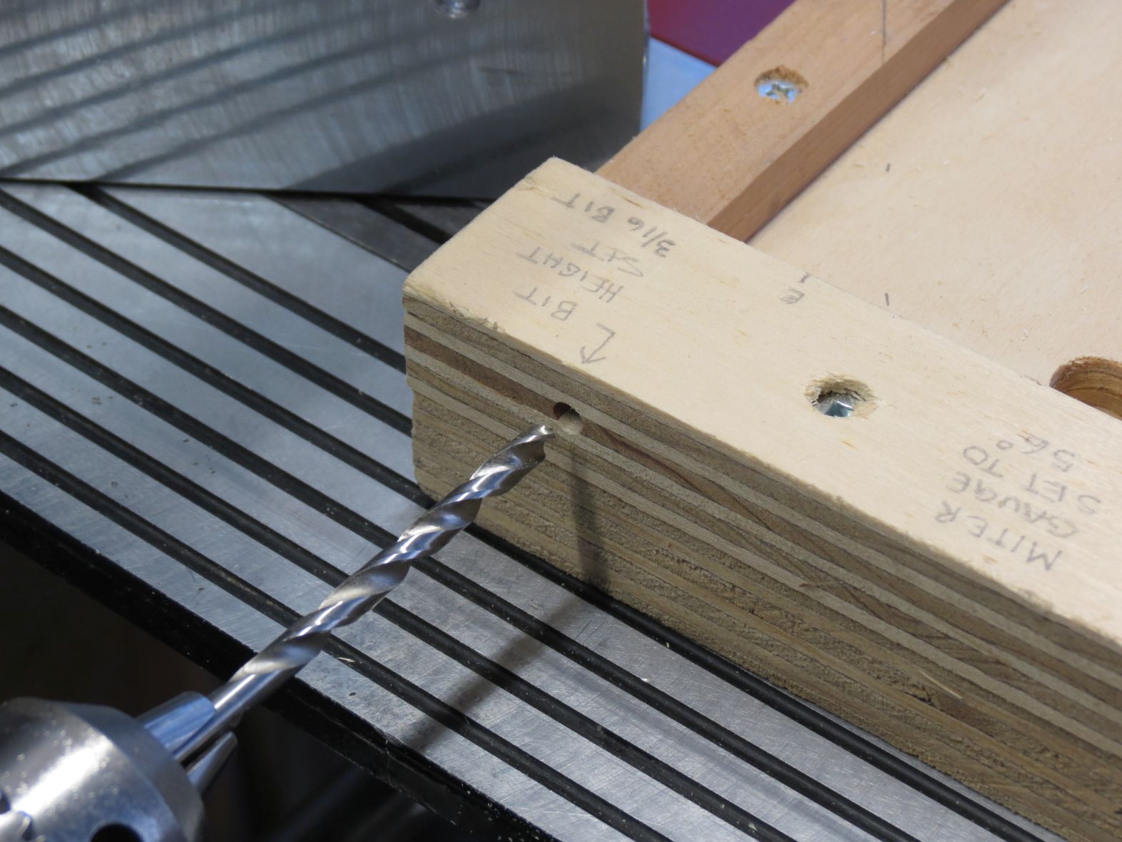

This is the jig I have for doing more operations. First it has a hole that is at the center of the bears thickness. I can just use that to find the table height for the horizontal drilling. You can see it here:

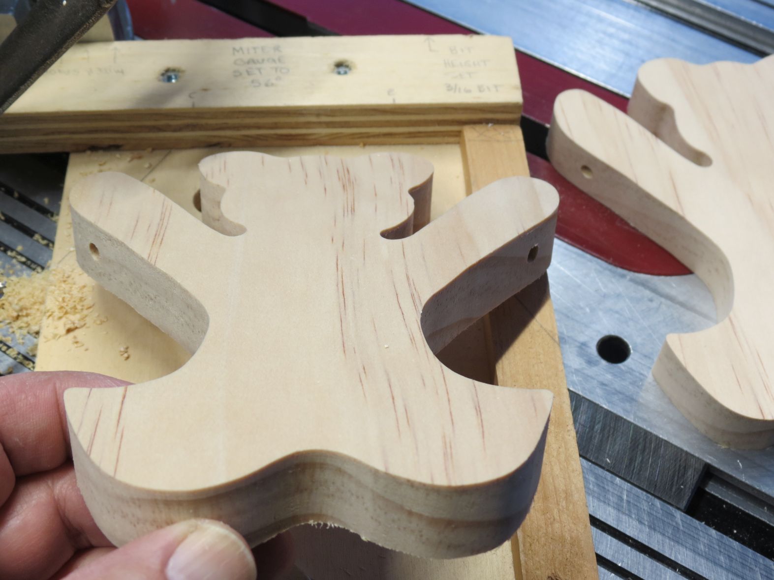

With that set I can then adjust the miter gauge angle and clamp the jig to the miter gauge. Note the dual washers on the bottom of the jig, they allow me to drill one side then loose the screw and readjust to fit the bears flip side. Remember the bear is not symmetrical.
The holes end up looking like this:
