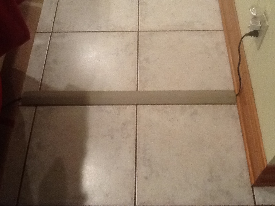

Is there a safe non-obtrusive way or type of extension cord to run under a rug

The safest way is to use a cover like this one.

I always heard it wasn't safe that is why I asked if there was a safe way. This weekend my recliner broke, the world is coming to an end, and my better half decided we will be getting a reclining sofa and love seat with one of them being electric.mmwhere she is placing makes plugging in a stretch.mmslab house makes putting outlet in floor more of a cost then I am willing to shell out so I will most probably go with the short covered extension as shown in answer above. Thx

You have a tough situation so your best option would be a cord cover like the ones in the picture from Gene. Leave it over the carpet so it is easy to see it's condition. The cord cover should help keep it in place while reducing the trip hazard. I am a retired Firefighter and putting a power cord under a carpet is a fire waiting to happen.

Went with protector.
